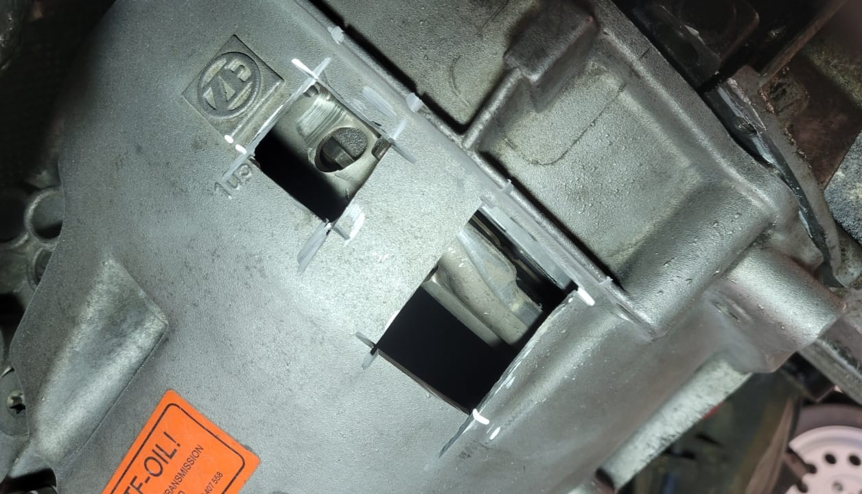

                      Yep clutch plate installed backwards. You're in for a world of hurt getting it out. You can get 2 of the PP bolts out through the slave cylinder hole. Then the others must be accessed through a access panel cut into the side of the bell housing. Heres the openings I made:
                      Click image for larger version  Name:	WhatsApp Image 2025-08-06 at 10.16.29 AM.jpg Views:	0 Size:	196.0 KB ID:	314625
                      Once you have 4 of the 6 PP bolts out then you will need to rotate the transmission in relation to the engine to get the remaining 2 PP bolts out.
                      Getting the clutch off from the guide tube is a whole other tub of fun involving 3 jaw pullers and sawzalls.

                                I appreciate the help and this is most definitely the culprit. I haven't been able to confirm for sure as I just got my hole cut. I kept the hole as little as possible. The plan is to weld this back up and hope it doesn't sacrifice too much strength.
