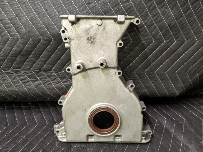

                  they lied, you can get the timing cover off without removing the head. few bolts ezpz, you can see the top holes on the cover, that bolts into the head. Remove those and the rest of the bolts, comes right off.

                  Here is a picture with the timing cover off with the head still on. ​
                      The issue is the timing chain overhang is sealed against the head gasket. So if you remove the timing cover you could introduce a leak from the timing cover/block/head joint. I'd guess that is more of an issue with an old head gasket. If there ever was a situation where you could get away with not removing the head...it's this one.

                          It might not come out as easy as this sounds, because the head is pressing down on the timing cover.
                          They didn't lie as it is hard to seal between the head and the timing cover doing your way, and not easy to pull the timing cover as there is the dowel pin on the timing cover and it's like an interference fit between timing cover and the head.
