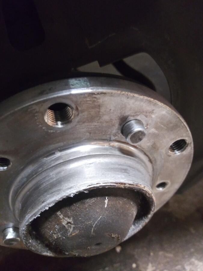

    Finished up my front 996 conversion this morning. Will do the rears next weekend. Thanks to Tbonem3 and all those who contributed to this thread, the conversion went (almost) flawlessly.
    Just to add to the wealth of information in this thread:
    • Two of my rotor set screws were rounded out. The previous tech who did my front brakes reused them, despite the hex head being rounded off. I could not get them off, with a hex or Torx bit. I think this is a pretty common problem on BMWs. I tried using a Dremel to cut a slit in the top of the screws, then using a screwdriver to get them out, but this did not work. If you encounter this situation, grab a drill, use a bit about 75% the size of the head of the set screw- and drill into the hex head until you hit the rotor. The head of the set screw should pop off easily, and I was able to get the rotor off. The threaded portion that remains of the set screw should come out of the hub easily with vice grips, since there is no more tension holding them on.
    • BUY NEW SET SCREWS when you are shopping for parts, they strip easily and cost $1 each at the dealer
    • If I had to repeat this I would buy 6 Centric caliper seal kits total, 3 for each front and rear. Then, I would select the best fitting seals from the kits and use those. They are cheap enough this is a good idea IMO.
    • If you do not buy the seal kits from Ohio Performance, you can buy the lube separately. It is called Centric disc brake assembly lube.
    • I had some great results wetsanding the color coat with 2000 grit before applying clear. I then wetsanded the clear and buffed with Meguiars M105 and M205 to get a very smooth finish.
    • BBS LMs in 19x8.5 ET +32 size clear the fronts with ease. I bought spacers just in case, but they were not needed.
