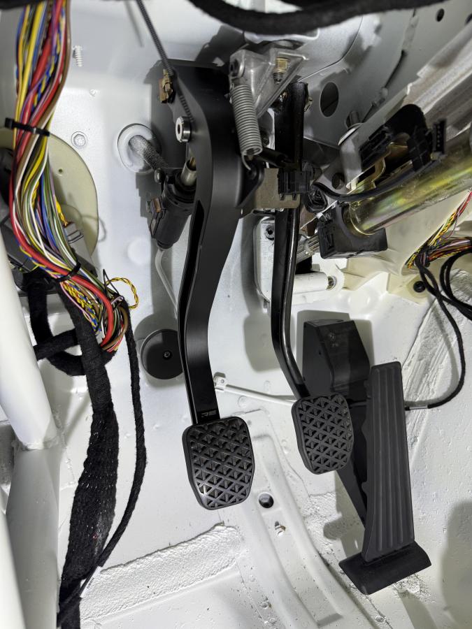

                          Just put in the Rogue pedal. Nice piece.

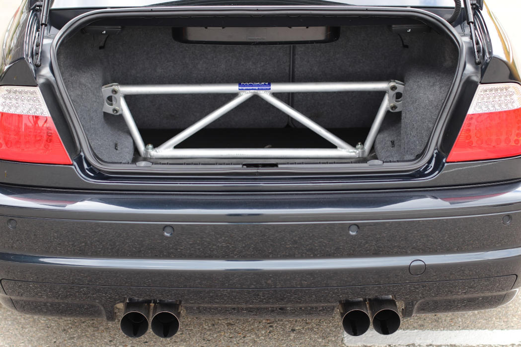

                            I spoke with him on the phone when I bought his GTR style rear subframe brace (which many have copied since and shamelessly lied about the work they put into designing it) and he seemed like one solid dude. Here's the brace installed in my M3:
