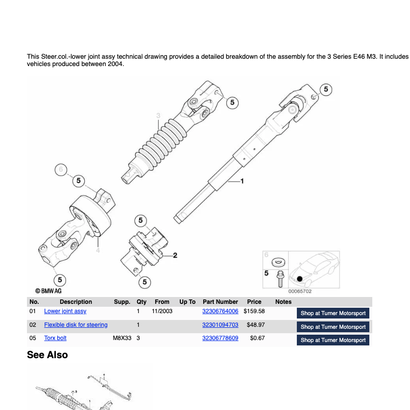

      I would say tie rod ends, but you changed that. Have you checked the lower steering joint (#5 in this picture)?

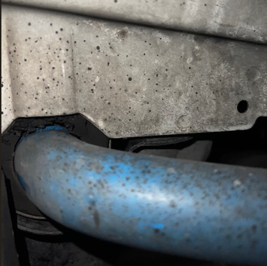

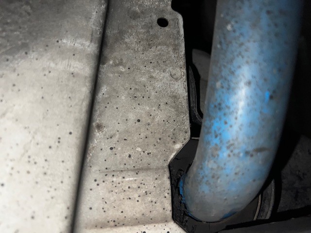

        prostcfc I am experiencing almost the exact same thing. Does it sound like it comes from one side more than another? What I hear sounds like it comes from the driver side. I inspected and it looks like the Driver front sway bar bushing is shot and maybe the sway bar is knocking on the upper chassis, see attached.
        If that does not fix it, I was going to start where liam821 suggested.
          I didn't check the sway bar bushings when I had the belly pan off (though checked the torque on those 4 fasteners and they were fine, but should have checked the bushings for wear). I'll take a look.
          What am I looking for in the steering joint? Just general play? I did check the torque on the steering rack to the front subframe and that was fine as well.
            Not saying it is the issue, but I would be curious how your bushings look. My plan is to replace the sway bar bushings first and assess.
            What to look for in the steering joint? honestly, no idea. I need to learn more but at 135k general play is fair grounds for replacement to me.
