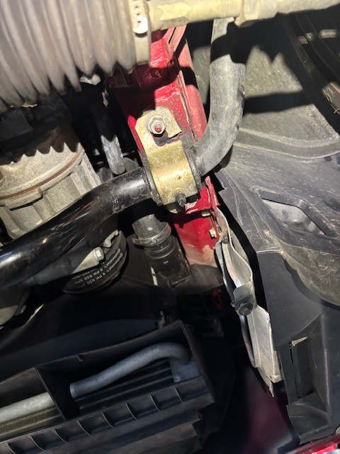

ID:	316503 I suspect many have cracked their sway bar mount, as did I. However I had the metal support welded in and thought I solved the problem. Turns out now my making bracket has cracked. This is on a Hotchkis front bar. Anyone else see this? Wondering if I can get a beefier one made, don’t think another stock Hotchkis bracket would also not crack.

            i've cracked a couple. see if your bar is making contact with pan

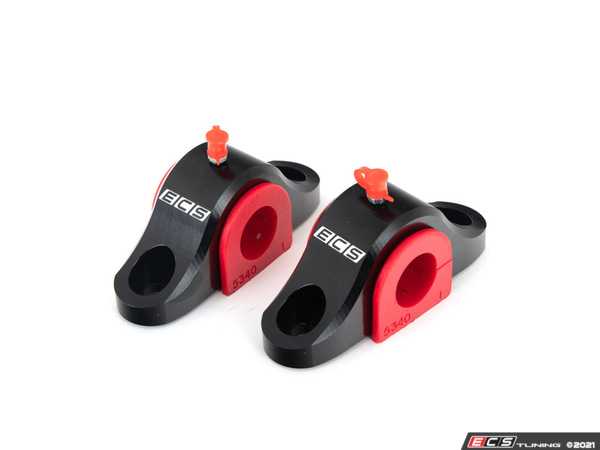

                ECS sells both the front and rear brackets... you'll need to source larger bushings to use the Hotchkis bars... I imagine reaching out to ECS they could make you a kit.

                  The CSL brackets (believe they use steel) are stronger than the standard M3 (believe are aluminum). They are also used on the non-M XI’s.
                  So the dilemma is do you risk pulling out a mounting stud with the stronger steel bracket or breaking just the aluminum bracket ear using stock.
                    Not the bracket but the stud out of the frame! Picked it up from the shop yesterday spent $600 on a repair + reinforcement kit.
