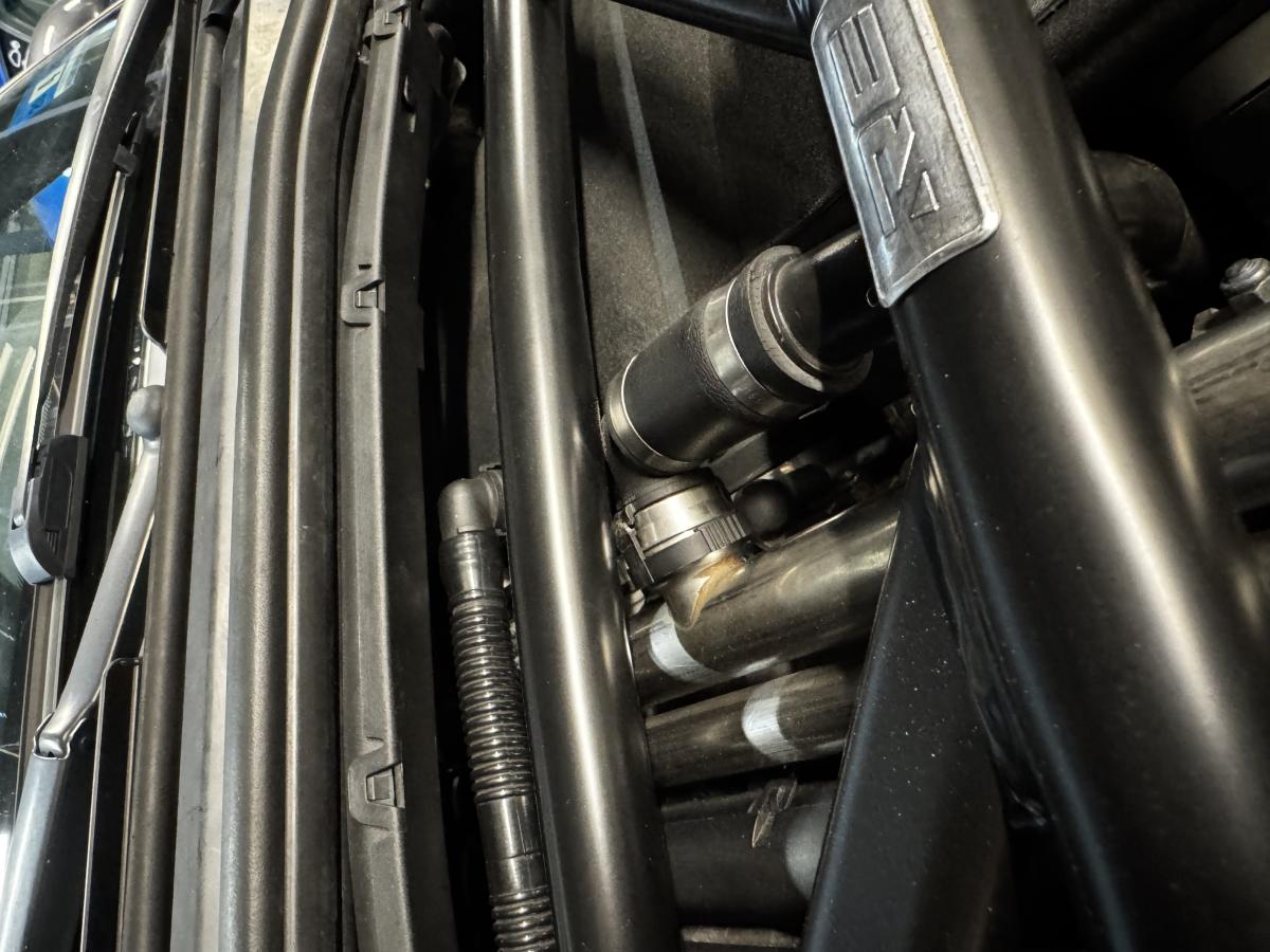

    Anyone run into strut brace clearance issues after putting in new engine mounts? I went with aftermarket mounts (034 mounts), it got rid of the horrendous idle NVH that the bimmerworld mounts the car came with, but now the brace is hitting the quick release fitting (and broke) that clips into the air rail.
    I’m now considering a different brace with a different design, or putting in Rogue’s bumpy strut tower spacers.
    Curious to see if anyone else has experienced the same.

      Are the nipples on the engine mount in the hole? That could cause it to sit higher.
        Problem is Rogue strut brace. I installed 3 in the last years and they all get in contact.
        Rogue strut brace used to have 1 bend on this tube and not has 2, given less clearence
          Bash the bar in with a hammer lol had to do that to my rogue bar to fit the s54 in my e36
            I made 1/4" shims plates on top of strut towers for the 3 cars that it didn't fit. People needs to contact Rogue when their parts doesn't fit
