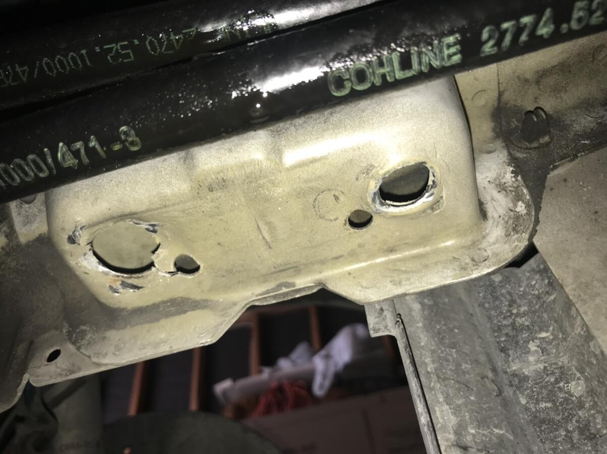

    I damaged one mount on my car when it had PSS10s (I think 360 lb/in F springs) and Hotchkis sway bar at the track.

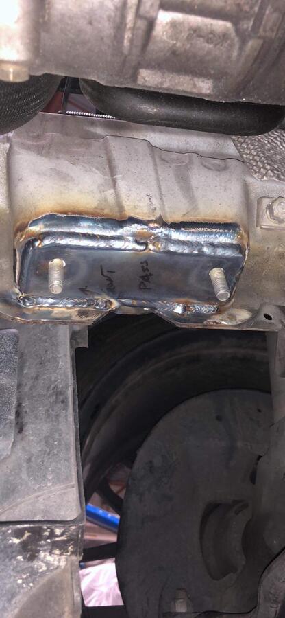

      This repair looks well done. Was this a diy metal plate or does someone make a kit? Hope you painted it afterwards.
