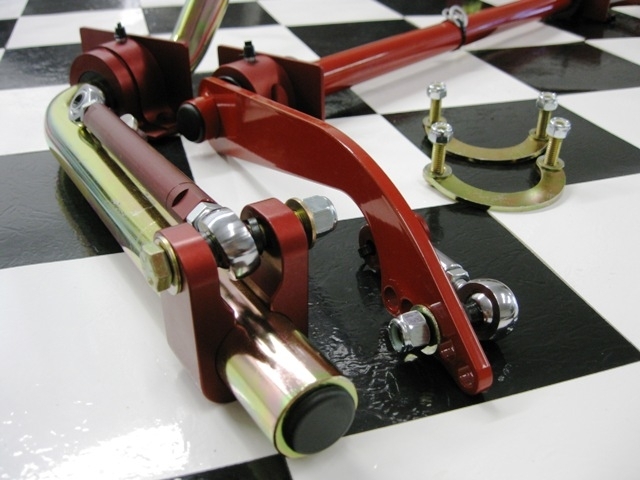

                            Some sways come with that-- E.g. the GC race front sway I'm running does:
                              Ahh good to know!
