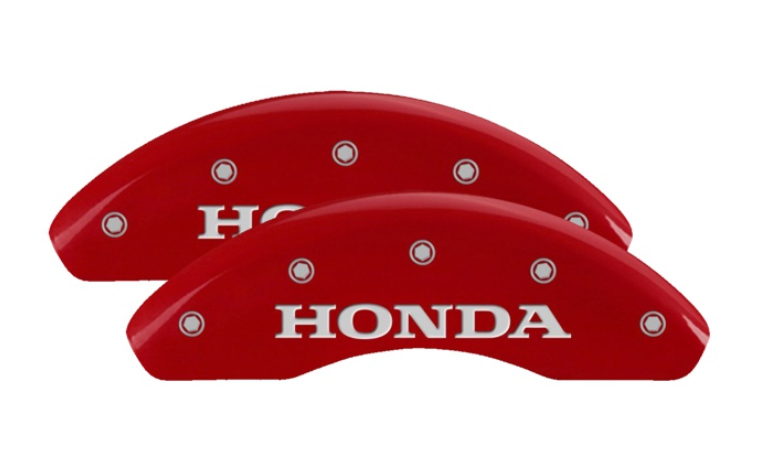

                  my suggestion for a street car if you must have a BBK for whatever reason, it should be based on a OE product
                    This.
                    Wrong.
                    This.
Name:	Screenshot 2025-09-02 083942.png
