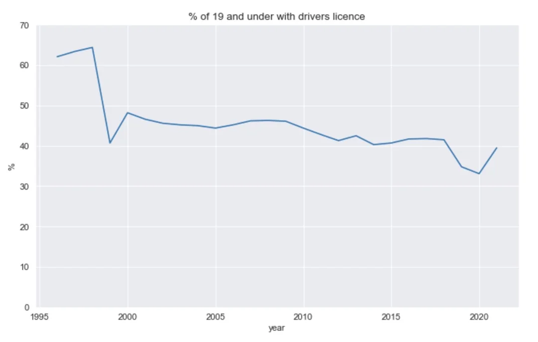

                        At the same time, maybe it's a natural trajectory. People are just less into cars than they used to be. Kids aren't itching to get their license at 15.5 anymore (see below graph). Plus, the world is saturated with incredible vehicles. I walk past McLaren and Ferraris and instead of thinking "wow, what an amazing feat of engineering!" I think damn, who's the guy with enough disposable income to drive this? Whereas back in the 90's just seeing a supercar was rare, and they were such an astronomical jump in performance from the average car that it was as much a status symbol as it was an objectively superior vehicle. Not necessarily the case anymore.
