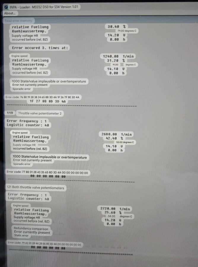

    I have been getting an EML, CEL and limp mode for about a year at random and very frequently, sometimes the car works perfectly, sometimes I can feel a slight miss and sometimes it will throw an EML, CEL and go into full limp mode and limit power and RPMs, I can’t drive the car anywhere out of fear because it happens so frequently. I have just got INPA installed and scanned the car but here is what has been done so far.
    Previously I was using a Schwaben/Foxwell BMW scanner and getting codes
    "P1637- throttle valve position control deviation"
    "P0121- throttle/pedal position sensor/switch “A” circuit range/performance"
    "P0221- throttle/pedal position sensor/switch “B” circuit range/performance."
    I have replaced both TPS under the hood, throttle actuator, throttle pedal, MAF and I have cleaned the IAC and ITB’s, also the clamps on the airbox are not contacting anything when throttle is applied and ITBs open. I have also checked the ECU for water damage and found none, nor any corrosion inside or outside, I was expecting to find a little water since it seems to do it slightly more often when it rains but it does it in the dry as well.
    I have scanned the car with INPA today and it read
    "120 Throttle Potentiometer Comparison"
    "118 Throttle Potentiometer 1"
    "119 Throttle valve Potentiometer 2"
    "121 Both Throttle Valve Potentiometers"

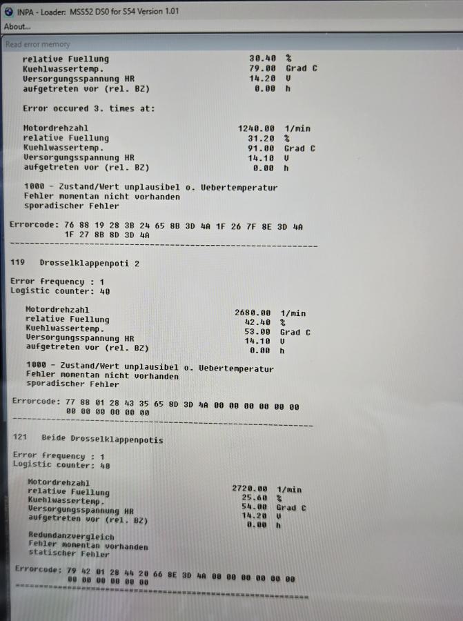

    When I scan the car everything is in German so I took pictures I will attach and used google translate. I admit I don’t really know how to use INPA that well and if there are any other scans I should be doing please let me know. I am at a loss, I don’t know what to do next, I have been having this problem for about a year and cannot drive the car because of it. Please help me I am out of ideas, thanks!

    Did you do throttle Calibration after replacing parts?
      I did the calibration where you press the throttle to the floor, put key to position 2, wait 10 seconds, turn the key to position 0 and then release the pedal. I saw a few different methods to calibrate, should I try something else?

            Look at post 6, perhaps time to check that the new TPS are indeed good.

              I'm on my 3rd set of TPS, first I switched both to VNE, when that didn't fix it I bought Genuine BMW TPS just to be sure, also the new Pierberg throttle body actuator had a new TPS on it so that has been changed another time as well, ugh lol. I am also on my 3rd throttle pedal, bought a new one, didn't fix the problem and sent it back to FCP and got another. I will read through that thread and see what info is there. Thanks for the suggestions people, I really have no clue where to go from here.

                    Use inpa to do throttle calib.
                      Thank you, I just did that, I will report back tomorrow after a test drive.
