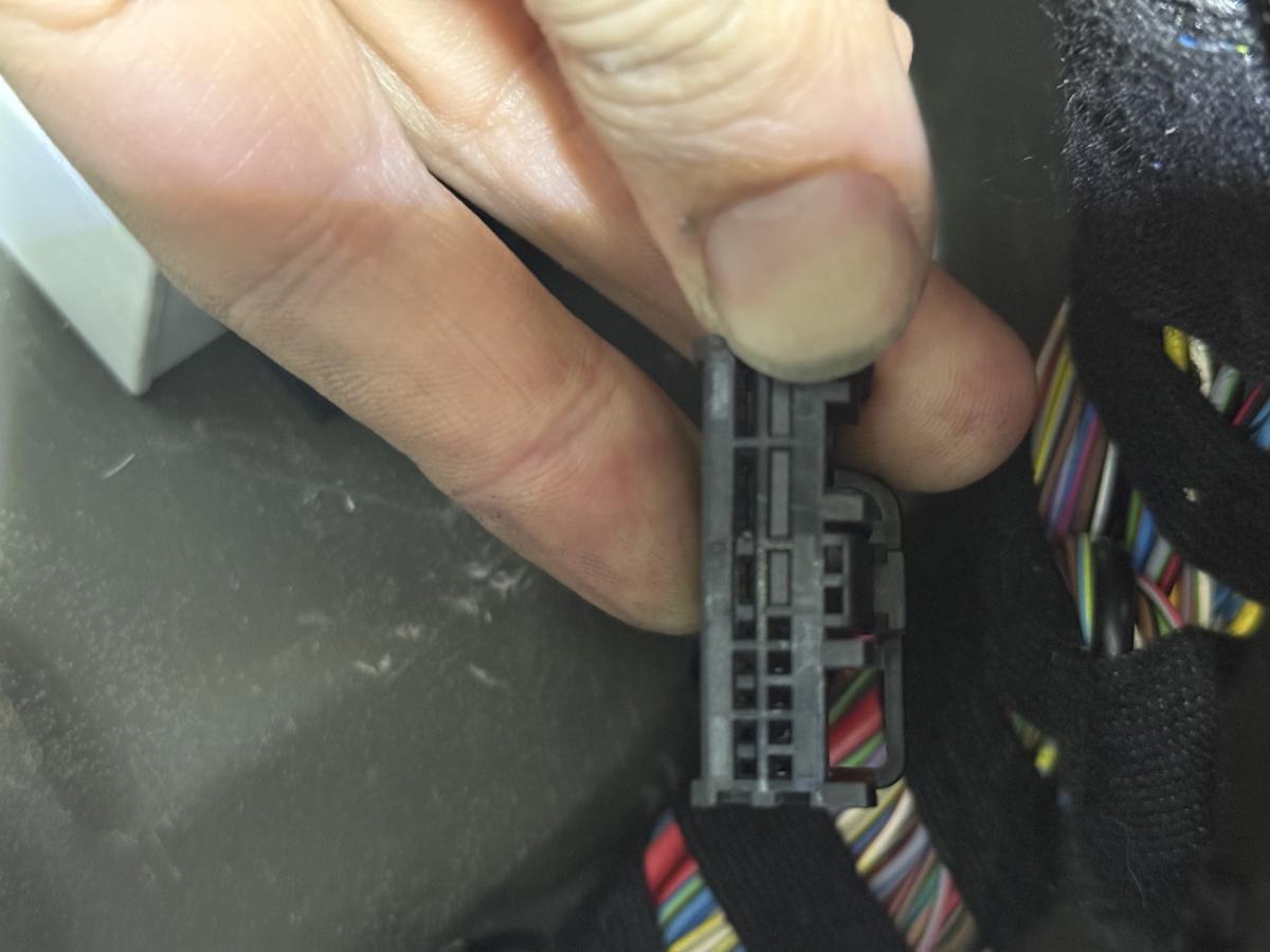

                            From a nearby thread, I’m having a similar problem with my engine not cranking. But mine clicks once, not the fast click click click that you have. That being said, I would like to troubleshoot the EWS like you have. Can you clarify what pin 1 and pin 2 you are talking about?
                            OK, to run the starter and bypass all of those N/P and SMG pressure threshold, remove the EWS and short out pin1 and pin2 using a 15A or higher fuse.
                            Also if the EWS disables the starter then it should not make any clicking noise when key turned to start. If indeed ews disabled the starter then even if you can crank the engine with the bypassing fuse, the DME will still not give sparks and fuel.
                            ‘04 M3
                              It's the two slots by my thumb, you will be able to insert an automotive fuse (like the ones in your fuse box) in there. No jumper wire needed. Also, conveniently, it's the only place where a fuse will fit.

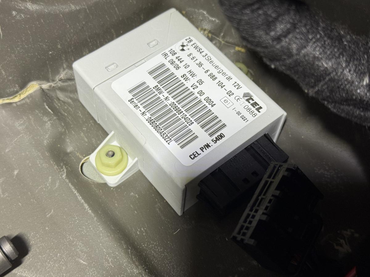

                              The EWS can be accessed by removing the plastic under the dashboard/steering wheel on the driver side.
