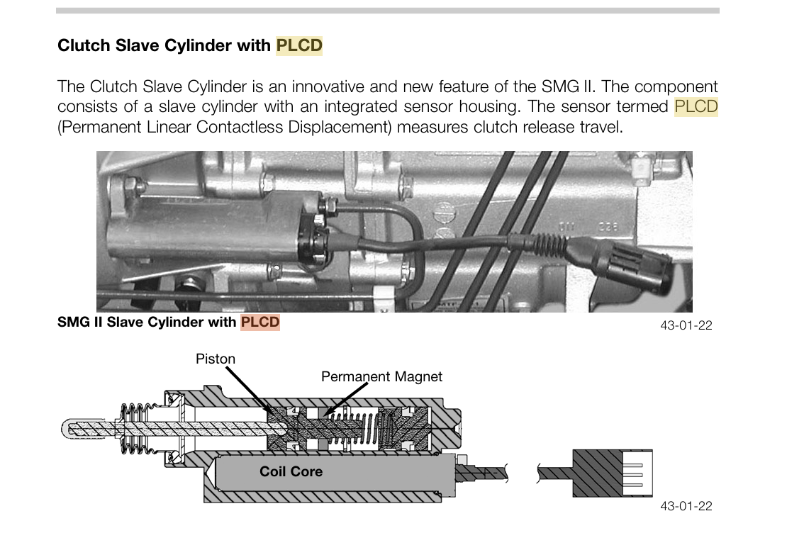

    From this, I think the PLCD output is a sinusoidal signal and the TCM has to keep track the number of the sine cycles and phase to know the slave position. I think the computer resets the counter when the slave has no oil pressure, then counting the sine way cycles and phase. The engineers used the simple coil generated sine wave for more reliable in the oil enviroment instead of linear digital encoder. But why the connector needs to have 3 pins, when the sinewave only needs 2 pins output?
    Btw, the slave rod must be moving fairly quick to generate a decent sinewave, as if it was pushed by our leg on the pedal slowly then the coil cannot generate the needed signal.

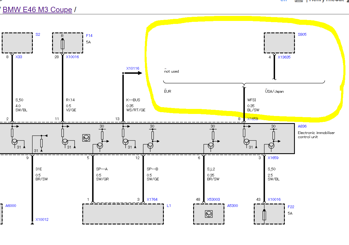

          pin8 only used for pedal switch based on this.

            I don't understand that comment about the diagram. What do S805 and X13635 represent?
            Is this diagram specific to the SMG?
              S805 is the clutch pedal switch and x13635 is the connector to it. So, the diagram is not just for SMG. This also means for SMG (no 3rd pedal) pin8 is unconnected.
                #37
                Yeah, I'm following. If S805 is the clutch switch, and SMG has no clutch switch, then this must only be for the manual. I'm still wondering if that's really what is implemented (after all the ambiguous stuff I've come across in TIS and technical doc, I'm not sure anymore), and the only way to know it for sure would be to take a look at the connector. Maybe I'll do it and report back.
