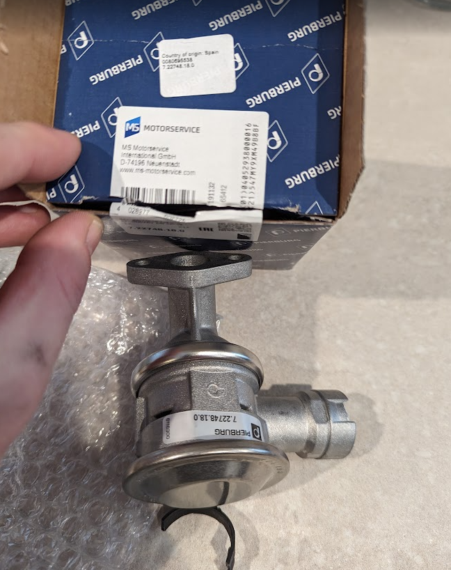

I just had a similar issue. I check and clean maf, ICV, fuel injectors throttle body intake ports. no dice, problem got worse eventually and it turned out to be the checkvalve on the SAP. I just deleted it.

do you have a picture of this check valve?
did you just remove the complete SAP , the rounded thing next to the header / windshield washer location?
I believe there is another backflow valve under the windshield wiper as well
I forget, but it might depend on the year. Mine is an 04 and it's a simple SAP setup - the fan thing, a hose, and the check valve. I believe older cars might have an extra vacuum line or something somewhere.
