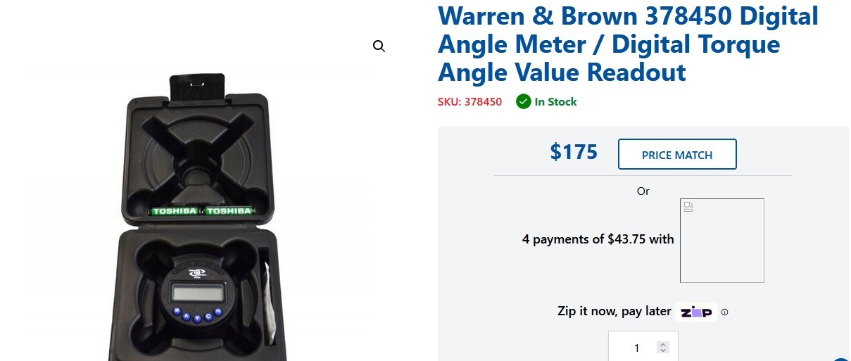

          Used one of these magnetic angle gauges on my torque wrench 1/2 inch
