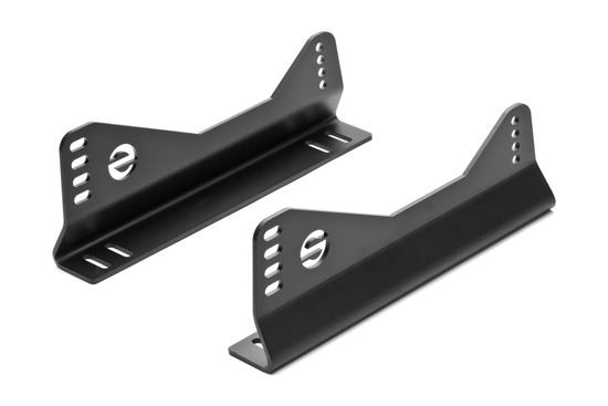

                    Sparco sells some terrifying side mounts:
                    Click image for larger version  Name:	0000109_side-mount-aluminum_550.jpg Views:	0 Size:	18.4 KB ID:	320320

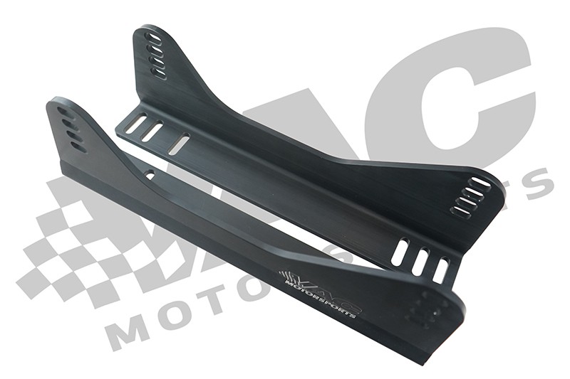

                    As does my least favorite BMW shop (VAC):

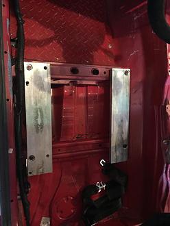

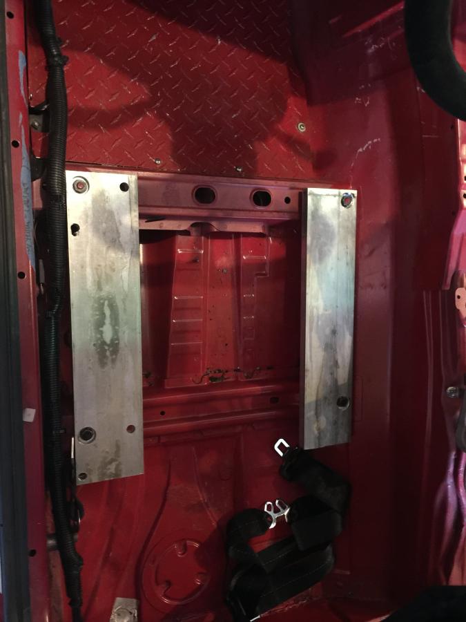

                      I'm gonna brag, I made MUCH stronger aluminum floor mounts. I drilled holes in the exact location, not a universal fit slot and the side mount is bolted through with a grade 8 bolt and secured with a grade 8 lock nut with grade 8 washers. in 2017 this cost less than $60 to make, only special tool you need is a forstener bit to counter sink the holes. These are 3/4" think, probably be fine with 1/2", when you bolt the side mounts to the floor mounts, it stiffens the floor mounts up a lot.
