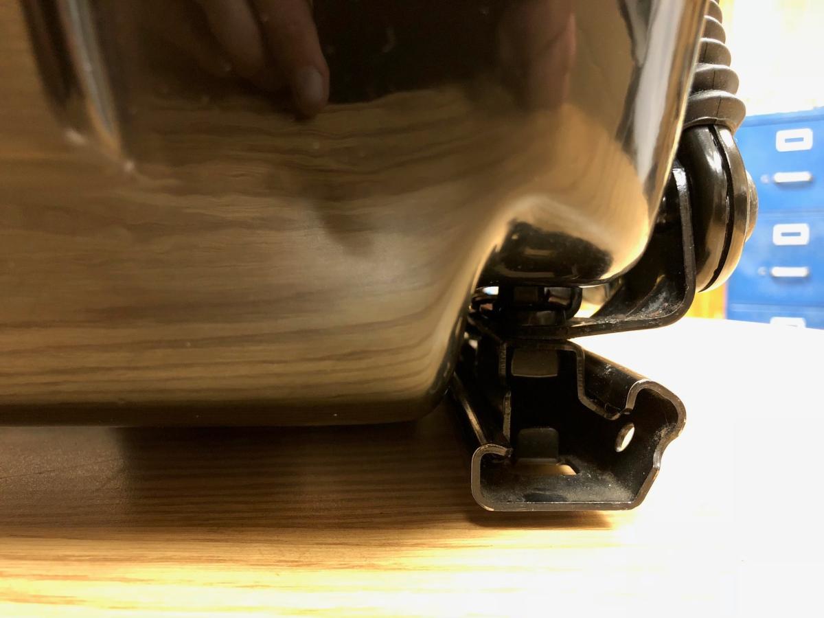

                    Click image for larger version  Name:	CS.jpg Views:	0 Size:	82.7 KB ID:	320164
                    CSs mounted on the OE Recaro mounts, in the lowest possible position. Clearly/visibly, not low :P
                    Also note the seat belt mount point above the slides that can't take the load of a seat belt in a crash.
                    I don't think the Recaro mounts are the standard that should be aimed for, here.

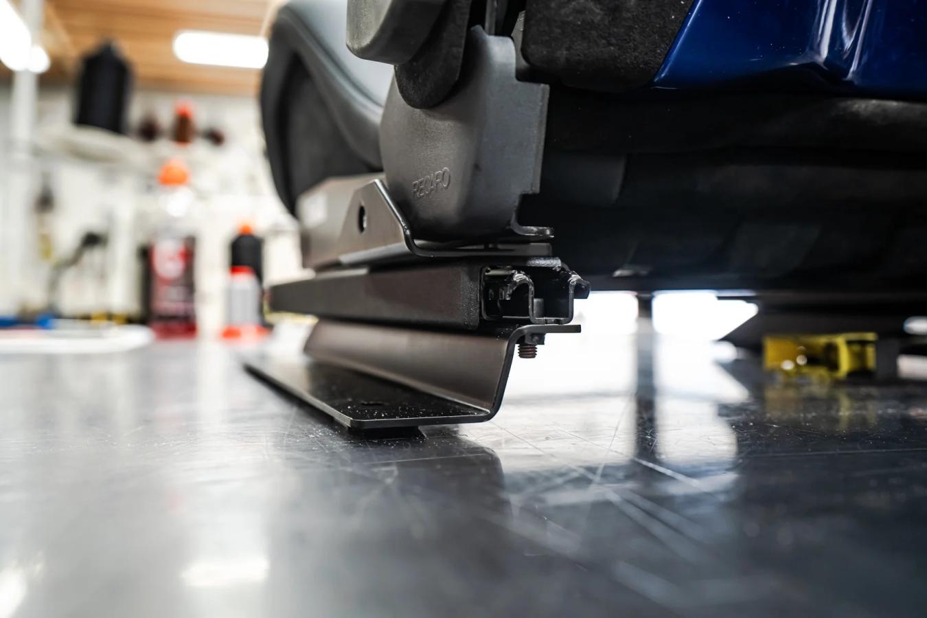

                    Vs, for context, my side mounted seat to the factory slide, with the seat belt mounts to the factory seat belt mount point:

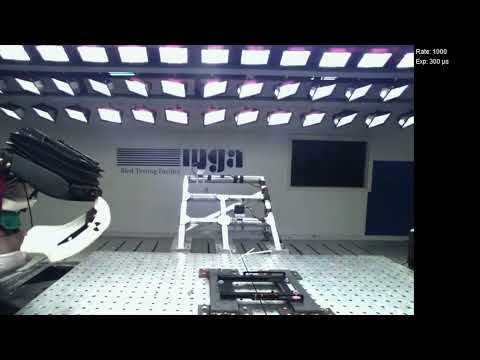

                      And just to drive the slider point home...
                      This video is the same slider that recaro sells:
                      ... really not something you want to mount belts above.
                          This is quite alarming to me.

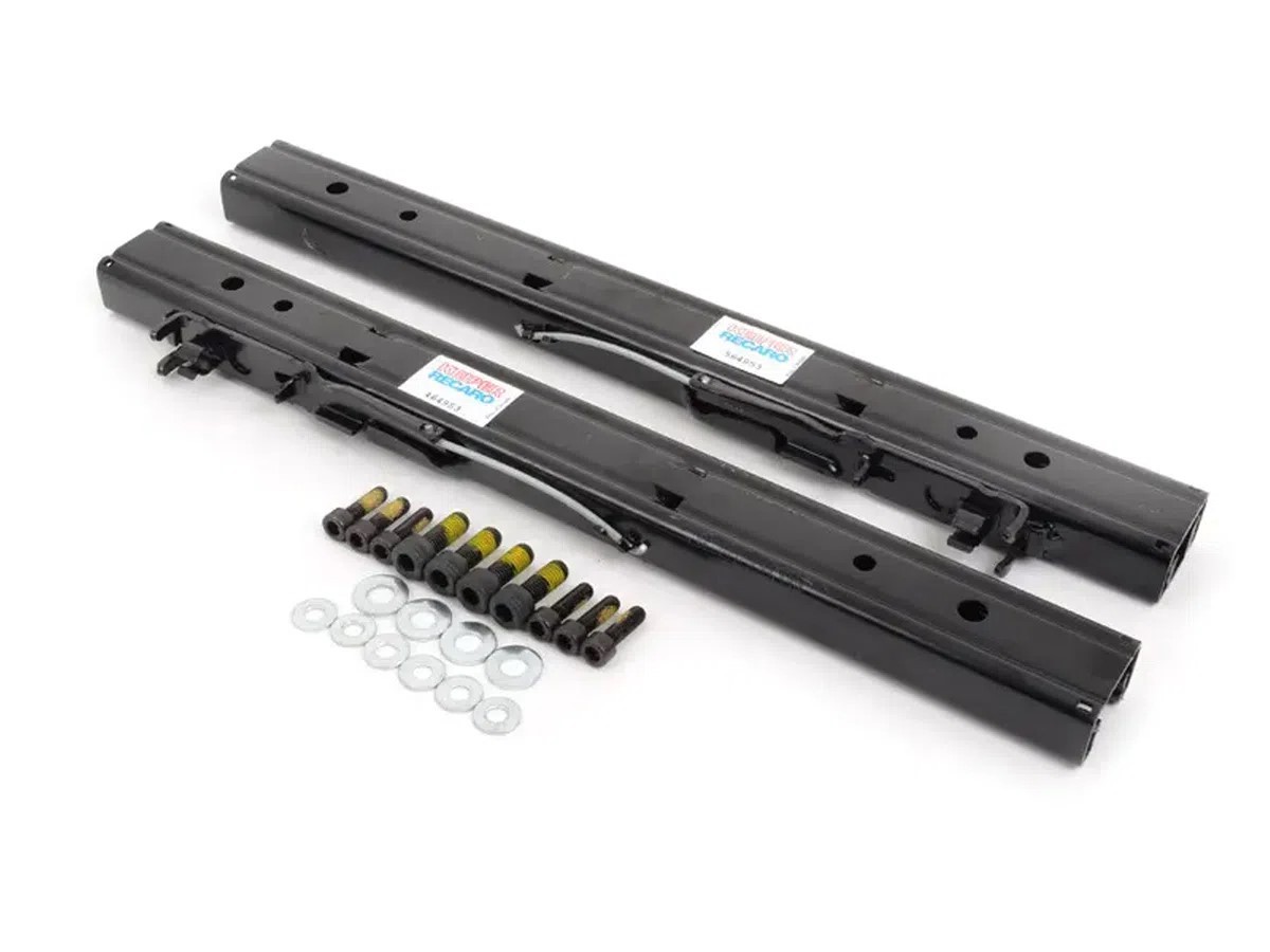

                            As far as I know, the only slider Recaro sells are these, with and without mounting tabs:
                            Click image for larger version  Name:	re.jpg Views:	0 Size:	88.7 KB ID:	320190
                            ^either way, the above style is what is being tested in that video.
                              That looks exactly like what I have.
                              Damn that looks unsafe.
