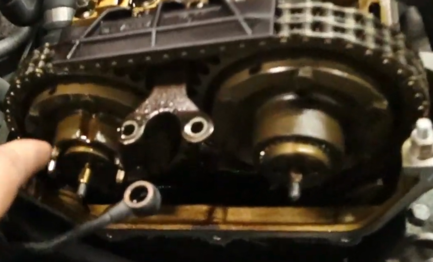

                Okay, here's where I'm slightly confused. It makes sense to me that removing the hubs themselves requires retiming the engine. But, if I'm not removing the hub, can't I just replace the bolts one by one? For example, the image below shows only the VANOS unit removed with the hubs/sprockets still in tact. Is the problem that the bolts aren't all accessible without rotating the engine?
                ETA: I was planning to do the Beisan exhaust chain guide. It looks like that requires removal of the chain/exhaust sprocket, so I may be stuck re-timing the engine no matter what. Maybe I am overthinking how difficult that is, I was just hoping to avoid it.

                  There is really no point at all to replace just the hub bolts, yes you could probably get away with doing them one at a time in star pattern, like a wheel.
                  The cam bolts are the ones that can back out and potentially smoke your engine so those are the ones to focus on.
                  Don't let timing the engine scare you away, if you follow the directions (Beisan directions are great) and have the correct timing tools you will be fine.

                    You cannot get to the cam sleeve bolts without changing the timing, because the hubs have to be removed.

                        Thank you - I was being an idiot and getting them confused. Understood now. Appreciate the clarification.
