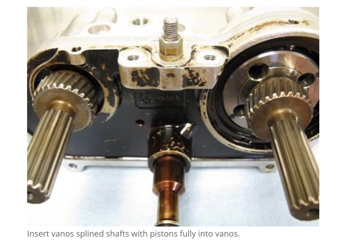

          This was a timing issue where the owner did not push the VANOS splined shafts and pistons all the way into the VANOS unit per the Beisan instructions. He was able to redo the timing and got the engine started.

              Yeah, came across that thread when looking at headgasket DIY info. Beisan really should underline and bold this part of the procedure:

                        You have to be careful when doing the Vanos procedure. Sometimes there’s oil behind one of the pistons which leads the splined shaft to move back out a bit after being pushed back (like a shock absorber) bmw therefore uses compressed air to reset the Vanos pistons
