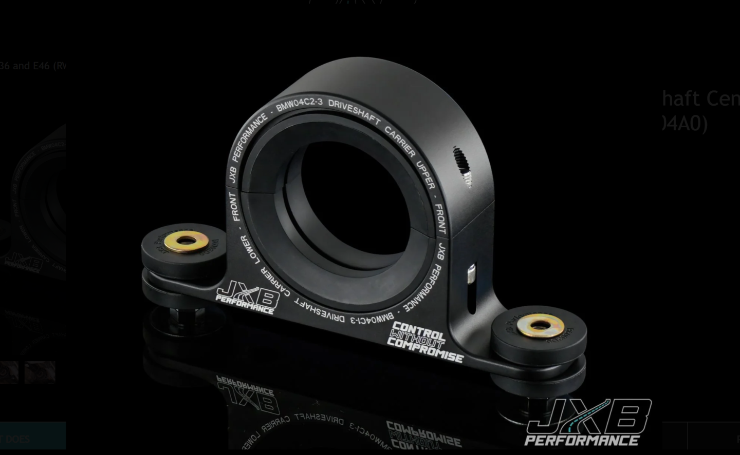

    I am thinking of getting the JXB Center Support Bearing, anyone have any experience?
    Performance propshaft carrier upgrade keeps your driveshaft perfectly aligned, reduces drivetrain slop, and doesn't sag or wear out over time. 2-piece design doesn't require removal of the driveshaft and installs easily without any special tools.

      That bearing support will just bring you extra noise and harshness.

        I am ok with the NVH. I will check if it vibrates when revving.
