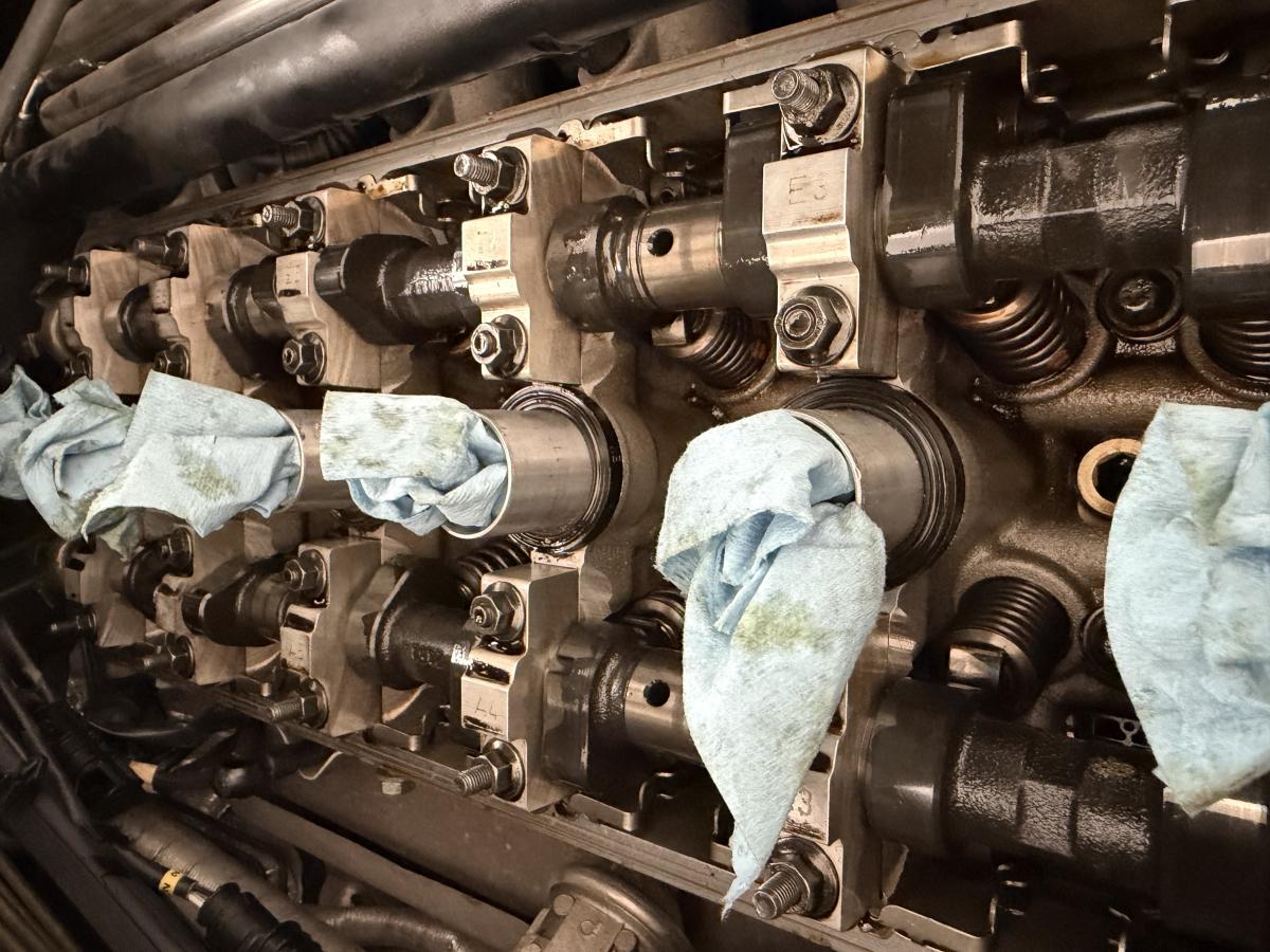

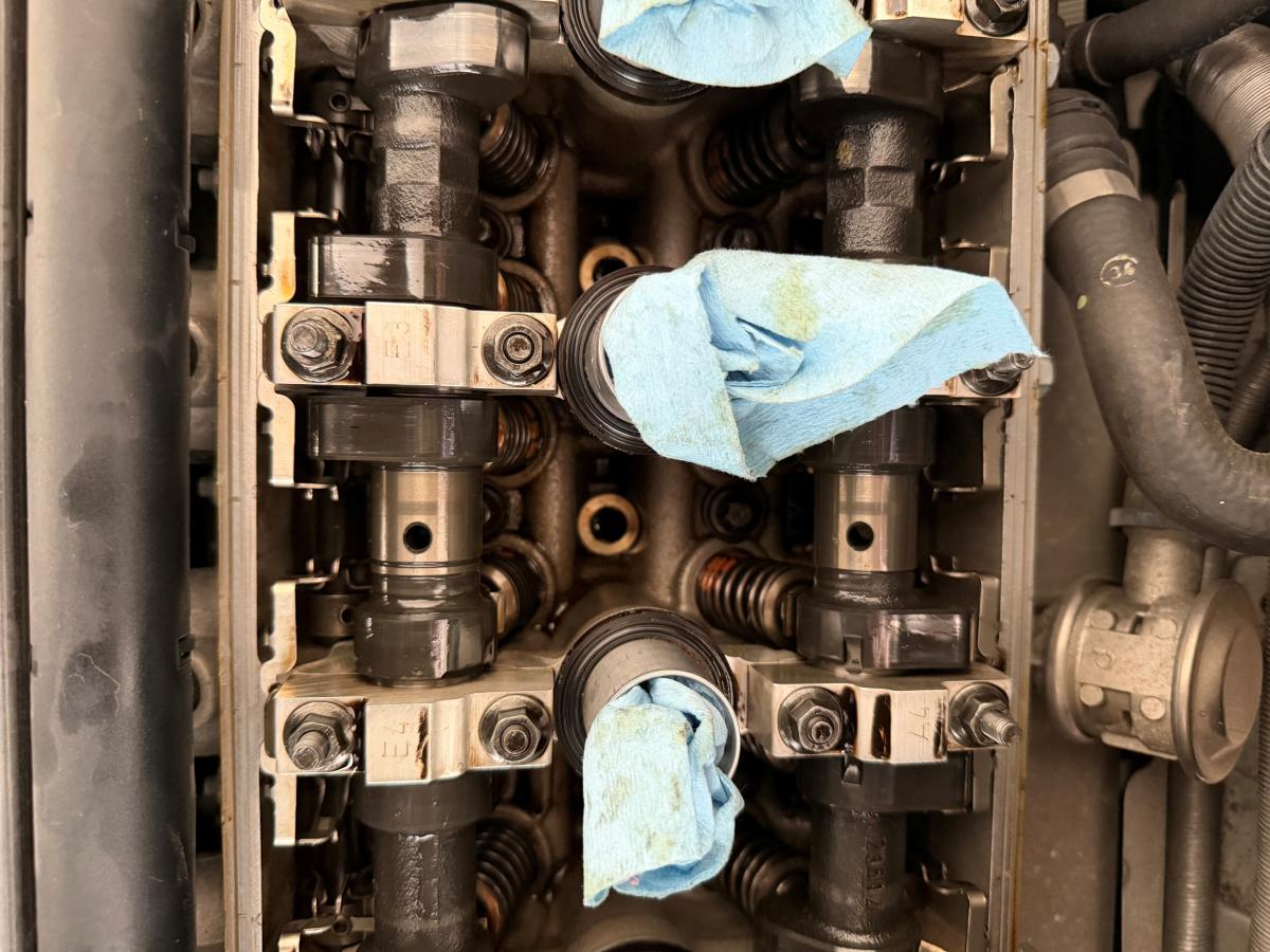

    I'm working to bulletproofing my VANOS and am at the stage where I need to retard the camshafts. I am following the Beisan procedure and also referencing the ShopLifeTV and Fatboys Garage YouTube guides. I have the engine at TDC with the BMW locking pin inserted. I have also removed the solenoid pack and VANOS splined shaft covers.​
    For the life of me, I cannot seem to retard the exhaust cam to get the cam aligning pin where it ought to be. It barely moves with a large 24mm open wrench. The intake is basically dead-on, although I didn't have to mess with retarding it to get it there.
    Any ideas? Just hit it with my purse?
    Thank you.
