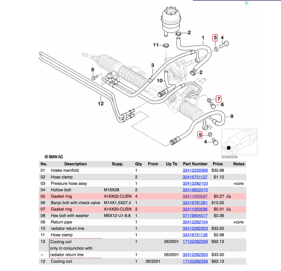

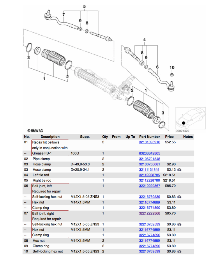

    32301094703 - BMW Steering Coupling Assembly - Genuine BMW
    32112228786KT - BMW Tie Rod Kit - Lemforder (OE supplier for BMW - correct me if I am wrong here)
    32411093597 - Power Steering Bolt Crush Washers x4
    32411093596 - BMW Power Steering Banjo Bolt Washer - x2
    32306778609 - Steering Coupler to Steering Shaft Bolt -x2

    Looks pretty good to me, I'd add:
    Steering coupler bolts (x2) 32306778609
    Rack Lock Nuts (x2) 33306760587
    Order a few extra banjo bolt washers, they are cheap and if you for some reason have to break the connection again, you have spares.
    When I swapped my rack I also did the coupler (Genuine), FACBs (Genuine), LCAs (Lemf.), inner/outer tie rods (Lemf.), sway links (Lemf.), sways bushes (Genuine). My hydraulics were all previously replaced. You may want to replace the M6 bolt (#8) that fastens the high pressure line to the subframe (for good measure). And on a side note, ran the LiquiMoly Toptec 1200 ATF in it for fluid. Feels great now!

          Washers for reduced assist?
            For my purposes - no. I am replacing the single use crush washers (5 & 7 in the diagram below).
            If you're interest in that particular mod, check out Tbonem3 build journal page 17 post 254

            📸 @alpinem3
              I'd check if the boots are ok, recently replaced mine they were ripped.
                He's got a point though, now would be the time. I think throwing in at least 2 washers is a nice little mod, esp if you're there already.
