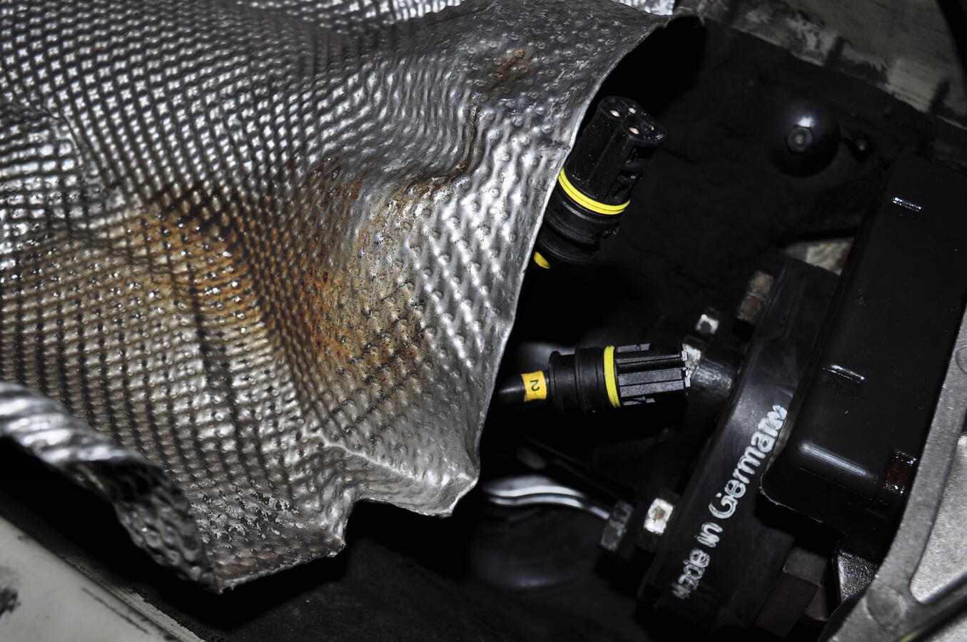

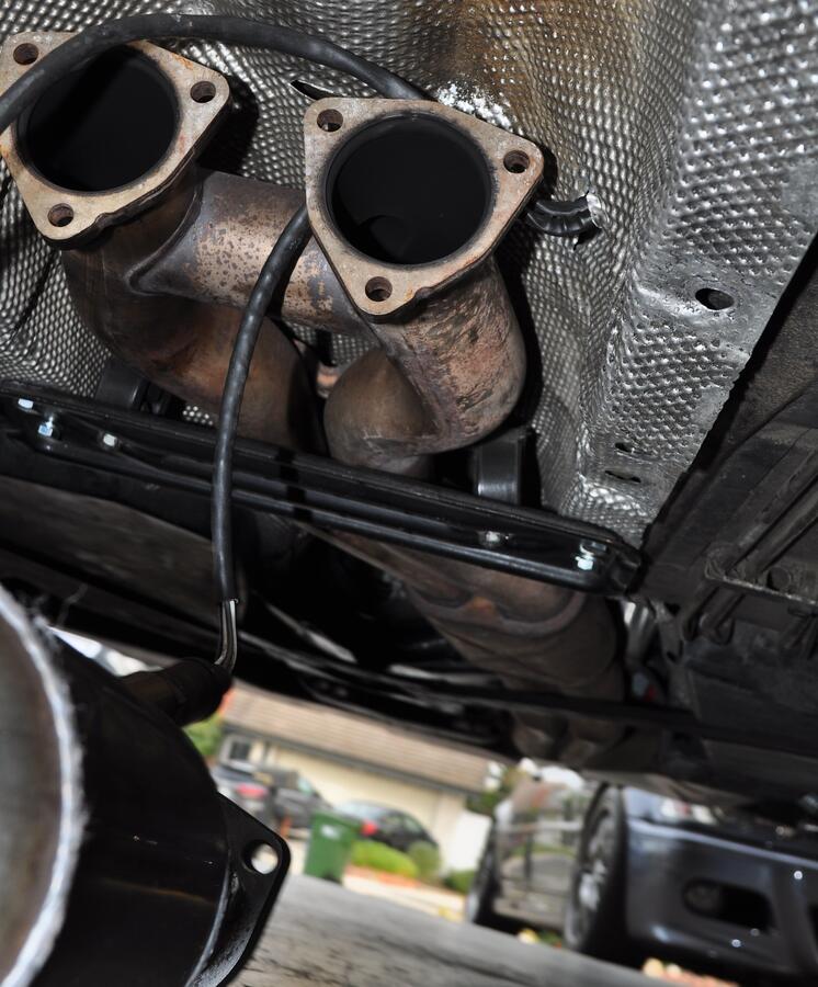

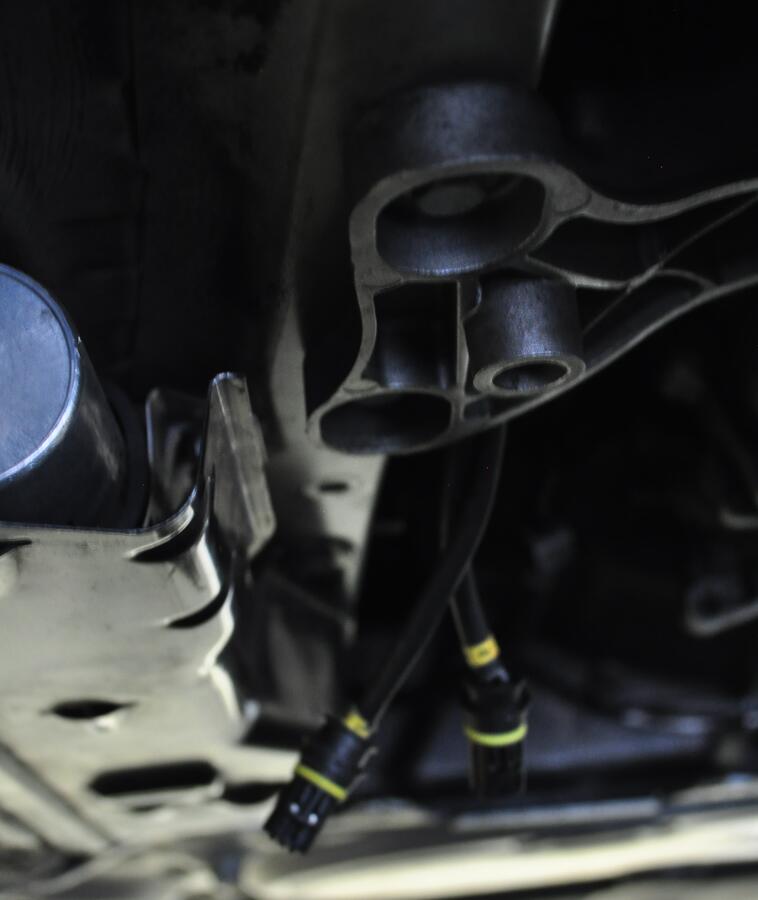

          Before installing the sect 1, I routed the O2 plugs through a hole in the heatshield (made when I had euro cats) and run along the tunnel, driver side
          Click image for larger version Name:	silvergHJSgiubo13.JPG Views:	0 Size:	101.1 KB ID:	147812
          Hello
          Click image for larger version Name:	silvergHJSgiubo14.JPG Views:	0 Size:	179.2 KB ID:	147815
          Once the pipes are installed, I pulled the O2 plus as far forward as possible, to meet the harnesses that need to be run behind the airbox and down tranny/clutch line area (already done in 2014). They'll reach a bit past the tranny brace. It's actually a good area for them to meet the harnesses as there are already some clips for the wiring of the tranny sensors.
          Click image for larger version Name:	silvergHJSgiubo15.JPG Views:	0 Size:	39.4 KB ID:	147814
          馃
          I think this is the part I'm not understanding. Are you just showing the process of where the male ends of the harnesses got routed through ?

            Yes, at least in that post, there are no pics of any of the routing from engine to transmission as that was done back in 2014. I want to say I had some more pics/info at the time back on m3forum, but when I had to recreate this thread, I don't think I put the info in. I'll check to see if I have any pics from back then. I remember a thread on this forum with more info though, if you want to try searching.

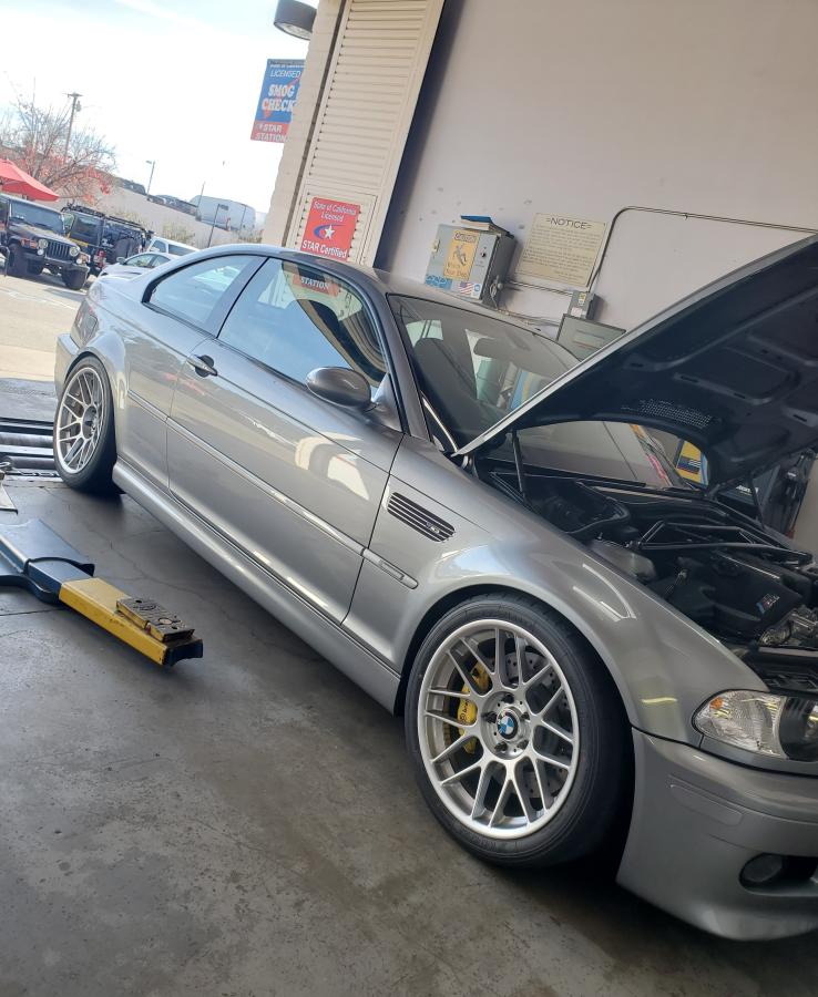

                        Bi-annual SMOG test

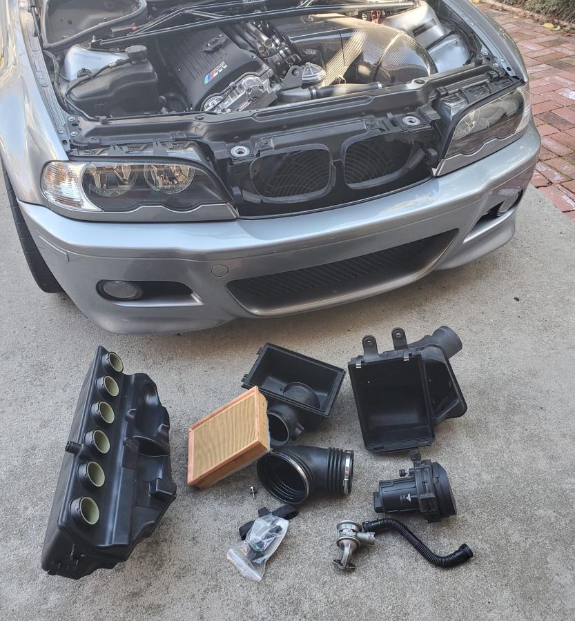

                        I posted the same thing, basically, 2 years ago, but I have something new to document this time 'round. Here's everything (hardware-wise) that I swap for the test:

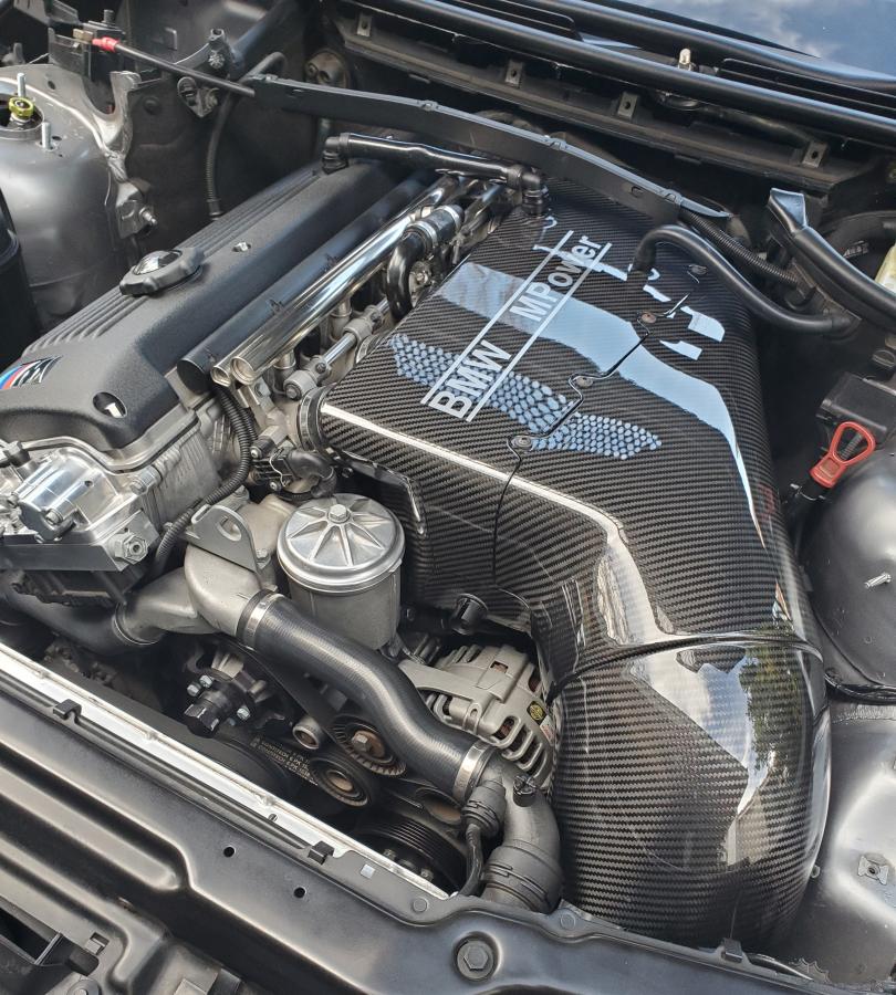

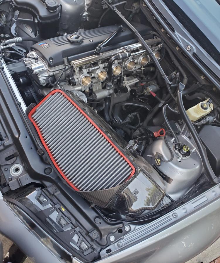

                        Not that I drive it much nor are conditions extreme, but the inside of the (karb) box looks brand new still as does the OE filter. TBs still pretty as well and those I cleaned like 8 years ago (20k)

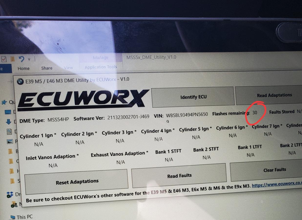

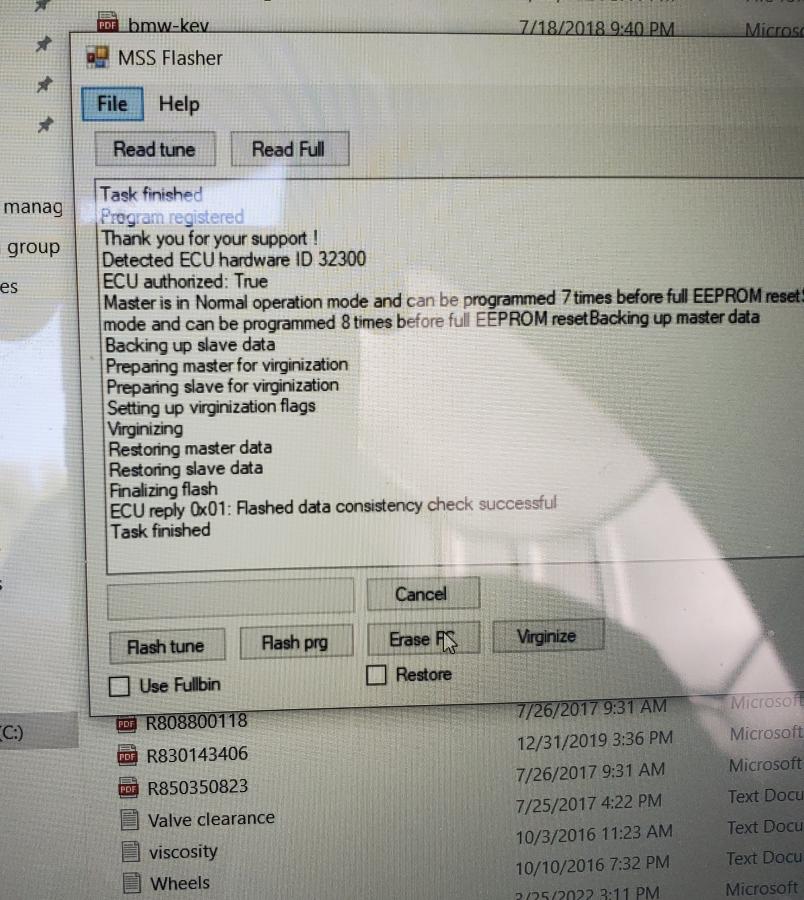

                        I've been tuned for about 8 years and have flashed back and forth probably twice that many times. I was starting to get close to the flash counter and, obviously, didn't want to brick the ECU, so I went ahead and finally purchased MSSflasher so that I could reset the FC, and flash faster than BMWflash (free) can do.

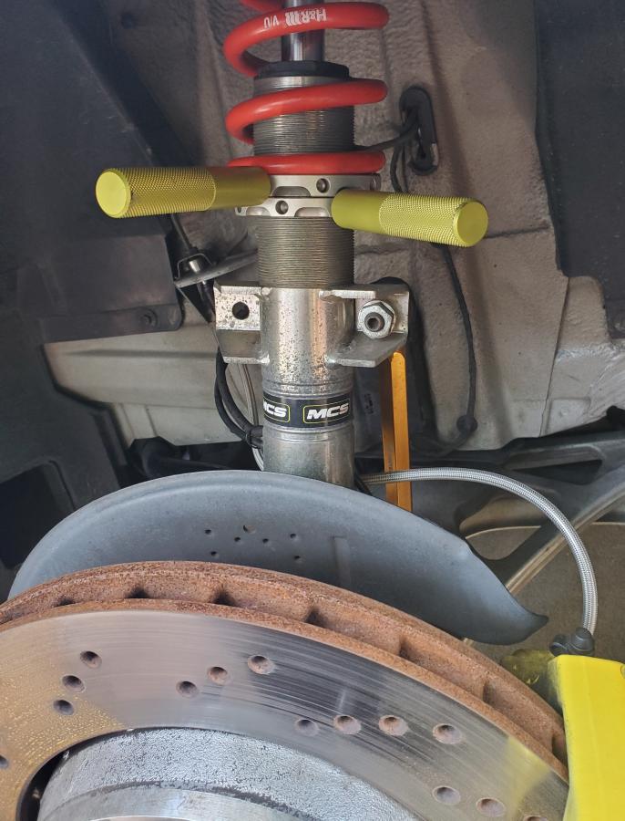

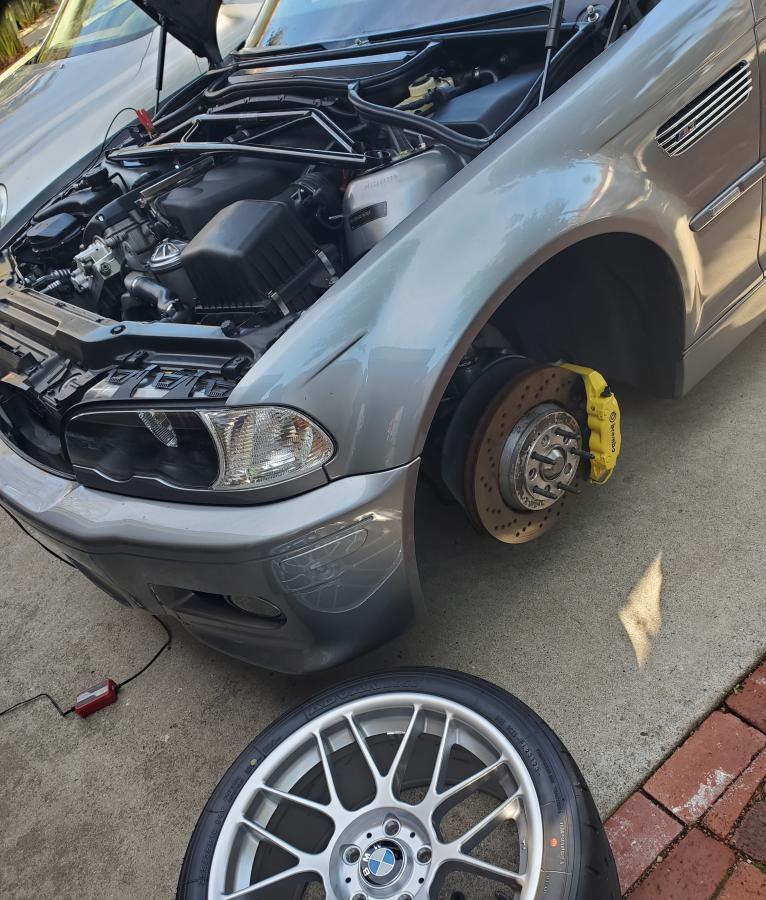

                        While flashing my alpha N tune (Evolve-R) back to the car, I wanted to lower the front just a tiny bit. After going down to 343lb rates in the front, I'm still playing with how low I can go without scraping the car in some of my favorite sections of canyons out here. I don't love how the car looks at 13.5" and above, but I know the car needs travel. Luckily I've the hardware and enough spring/light enough car that gives maximum travel, but lower ride height.
                        Took the opportunity to check on my new HEL brake lines, looking perfect particularly the rubber grommet that holds the line to the strut. The cheaper lines' grommets just crumble in my experience and don't fit too well anyway. HEL is perfect!

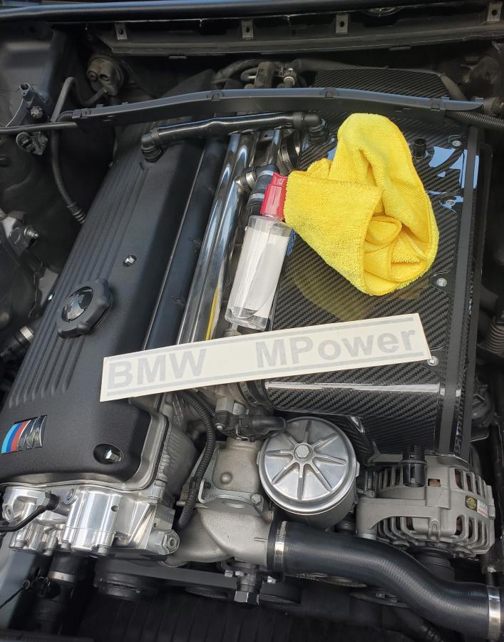

                        I was waiting until the next time I had the strut brace off to install my MPOWAAAAA decal to the airbox.

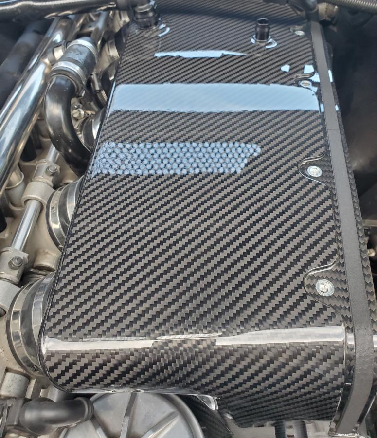

                        Look at the weave. Just look at it.

                        Next thing to do will be a decon, perfecting polish, and application of ceramic coating, most likely Gyeon Pure Evo that I still have about 40ml of (used 10 on the E90's E88s), but I'm still building out my garage and suffering through a kitchen remodel, so it may be a little while plus the E90/X7 are getting more focus these days :/

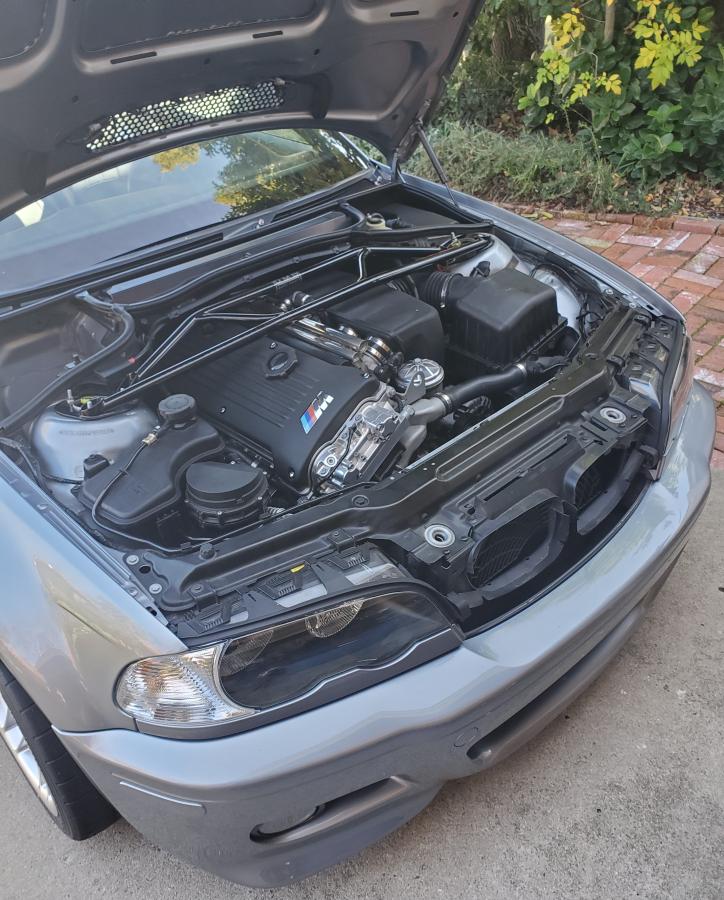

                                Triangulating the strut towers to the firewall will help gain you some of that E90 steering feel you're looking for
