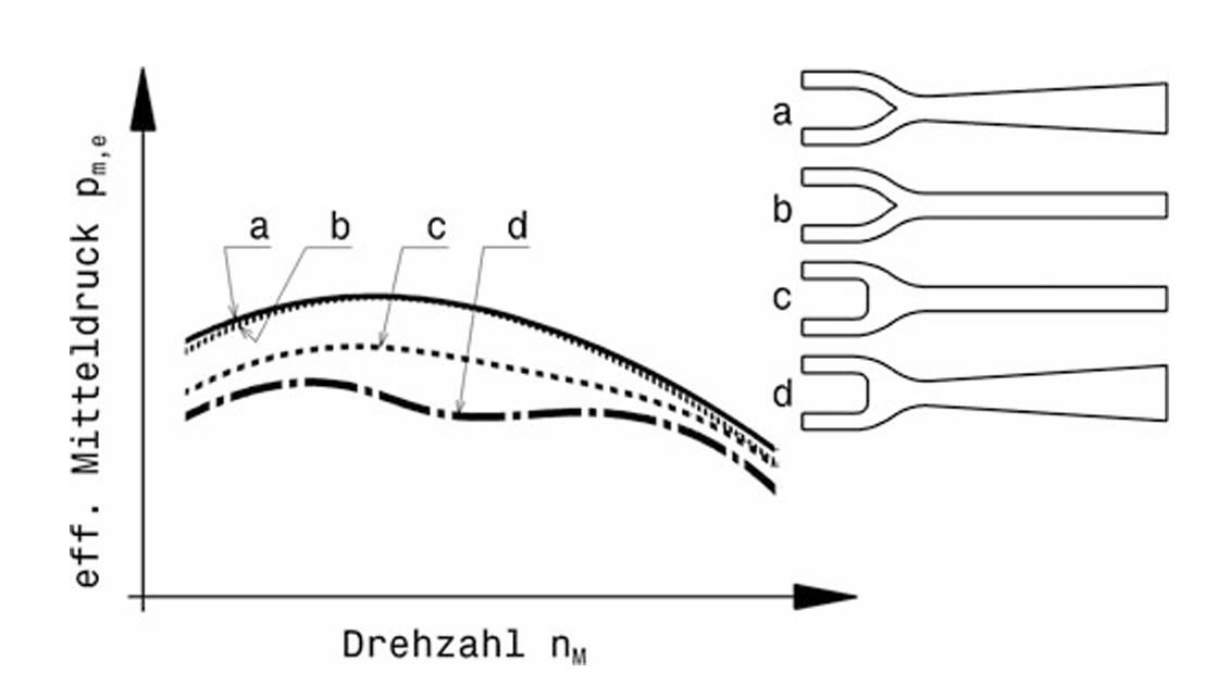

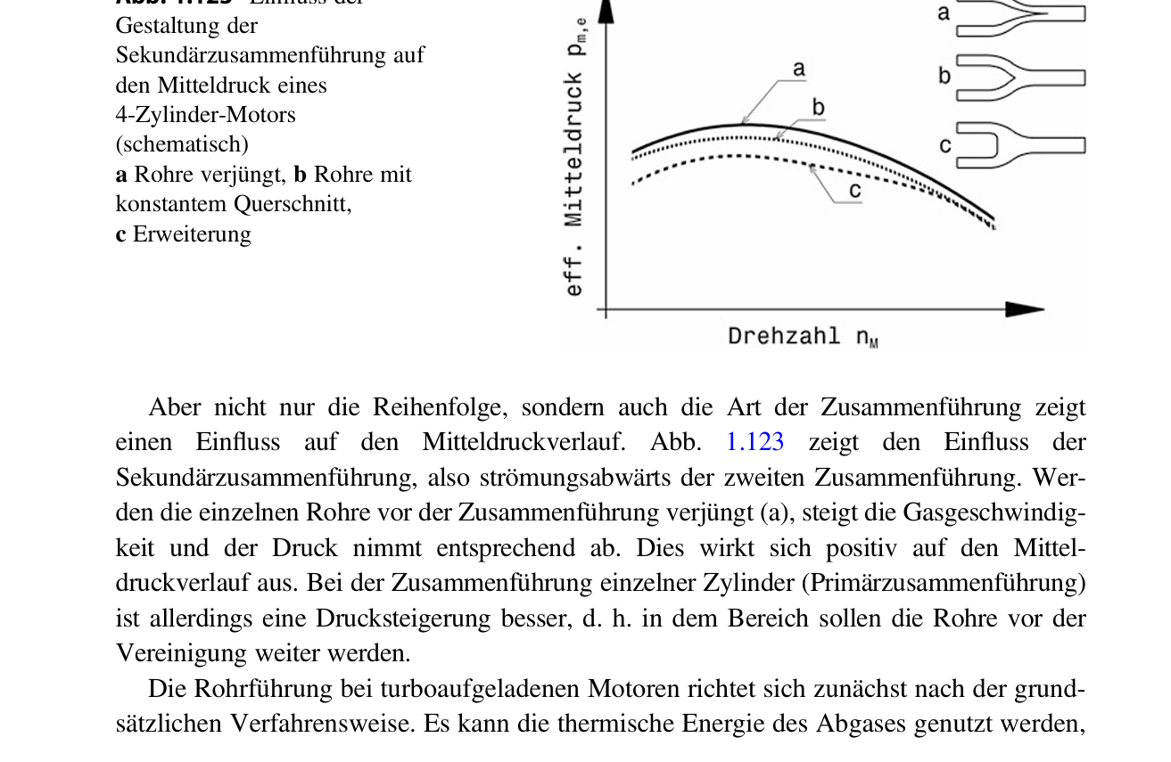

                    Back to header design and physics now. Let's for the sake of argument continue to ignore the muffler as a source of back pressure, regardless of religious e46 M3 affiliation.
                    The one concept I've personally always struggled to visualize is a tapered header runner (effectively infinite steps) and what that does to constructive/destructive interference of the resulting wave propagation. Somehow this is the 'ideal' shape but I must be dense as I can't 'see' the effect like simple wave propagation from a discontinuity. Since we're talking 3D printed headers, is it relevant to consider actually nailing this down, and is there a textbook that covers this well? I have 'Scientific Design of Exhaust and Intake Systems' here but that's the only literature I have handy.
                    Click image for larger version  Name:	image.png Views:	0 Size:	250.6 KB ID:	324620
                    This book basically states that its benificial to enlage header diameter before joining individual primaries into larger combined piped. Therefore is estimate a tapere header would have a positive effect. But maybe not more significantly than just enlarging the header pipe a bit before the joining point​

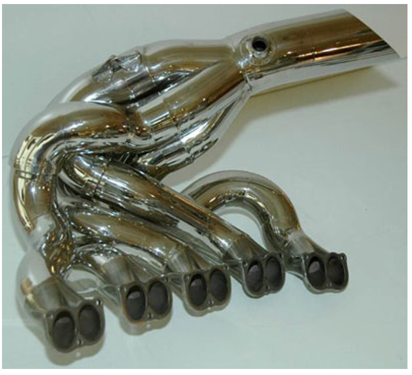

                    Click image for larger version  Name:	image.png Views:	0 Size:	616.0 KB ID:	324621​
                    in this f1 header its also possible to see the increase in diameter. Maybe at the beginning of the header it even also tapered / this isa v10 engine and the exhaust ports of one chamber are only merged in the manifold. Thus also reducing the distance/time hot exhaust gasses spend in contact with the cylinder head
                    Click image for larger version  Name:	image.png Views:	0 Size:	155.3 KB ID:	324624
                    design a and b seems to lead to best results ​
