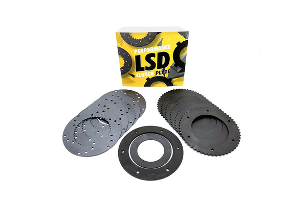

                      So what is consensus on getting new clutch packs? Only one i found was the kit from racing diffs
                      Unlock peak performance for your BMW! RacingDiffs' Clutch Pack LSD Rebuild Kit eliminates M Clunk & enhances handling for M3, M5, M6 & Z4M. Hassle-free installation, perfect for track enthusiasts seeking smoother drives. Upgrade your BMW now! πŸš—πŸ #BMWPerformance #LSDUpgrade #SmoothDrives
                      I believe the diff on my car is still on original clutch packs car is approaching 176K miles, should i be ordering new clutch packs to give to the shop, if i have my own unit rebuilt?
                        Nearly everything racing diffs makes is a waste of your money, especially the friction discs.
                          Not 100% true, the bearings are genuine Koyo, which are the factory option. Also the steel plates can be sourced separately, and the shims is up to you if you do them. The way I see it is that as long as you rebuild to the OE setup their clutches are fine. Their latest kit have you preload the hell out of the unit and that for sure will wear those quicker. There are a lot of bad misconceptions about rebuilding the viscous GKN units.
                          the M clunk fix is pretty easy with 2 * 0.1 shims on the bottom side gear. I documented all this in my build thread.
                            Their clutches simply do not last as long as OE-equivalent units. They are attractive due to their price but you get what you pay for. The bearings and items they do not make but supply are fine.
