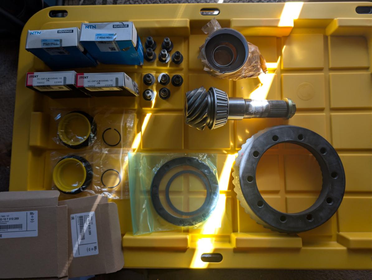

          Just follow up, just received all my parts from Pedro from Peakyparts, for 3.91 ratio swap. Great experience ordering from him. Diff rebuild with Wavetrac LSD is next.

                    Here is a pic of all the goodies
