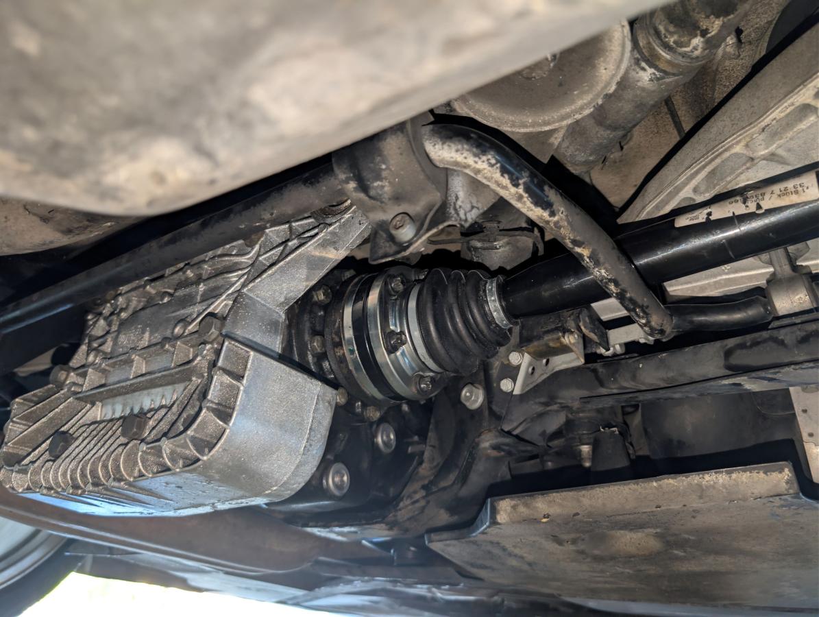

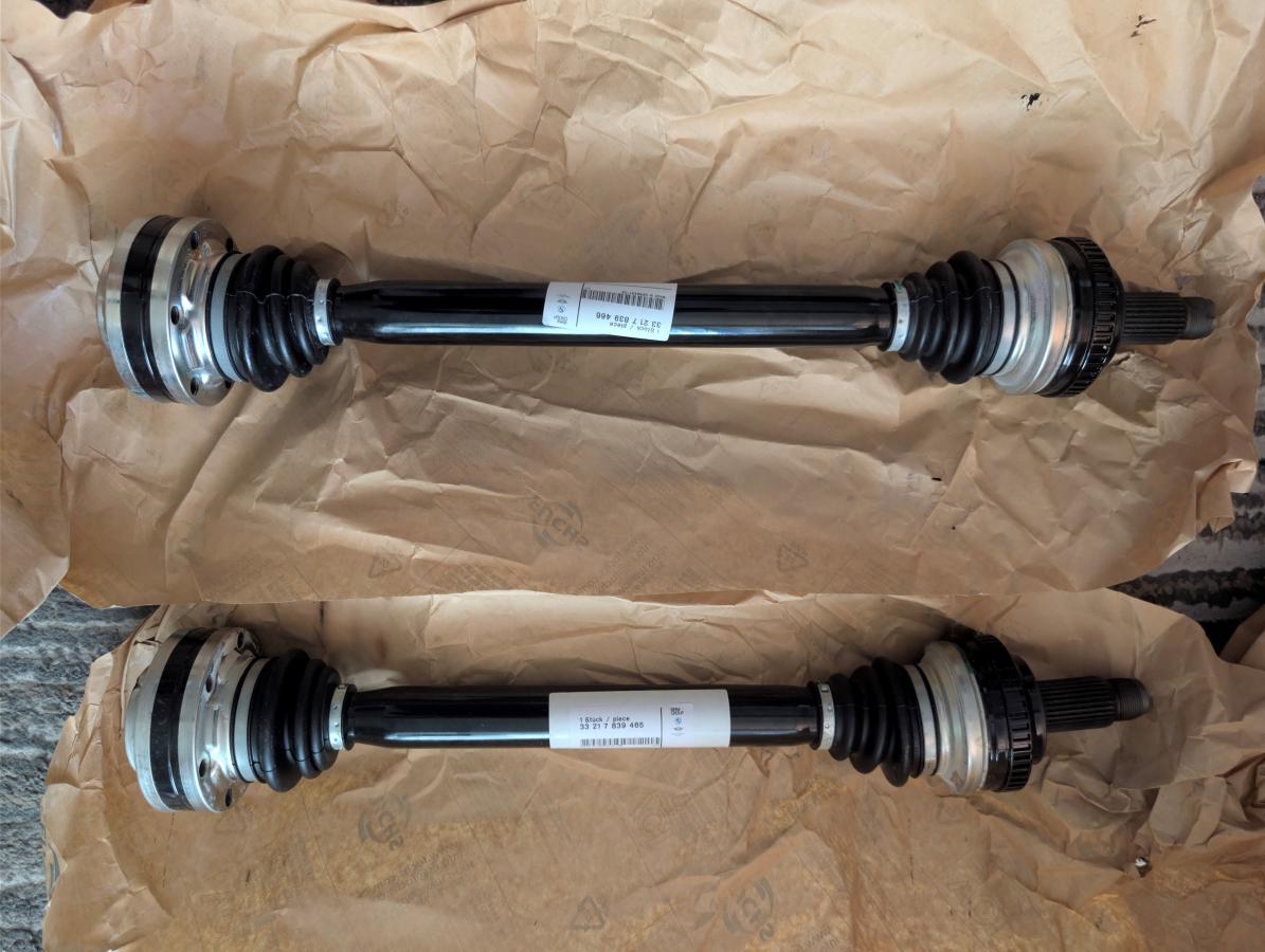

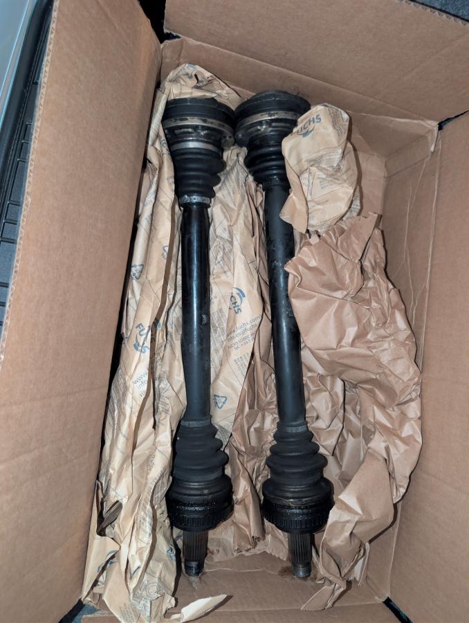

              So after about 1200 miles, i had grease slinging on both axles. Was going to re-boot the axles with indy shop, but labor was quite high and they wouldnt warranty it since i guess they have had some bad experiences with these axles and re-doing the boots. I decided to buy brand new axles, took like 3 week to get to me and finally had them installed.
              Took the first drive today from shop and the car feels real tight, no clunks that were present before with old axles. here are some pics old and new

                #52
                Well now to finish off this thread, i hope.
