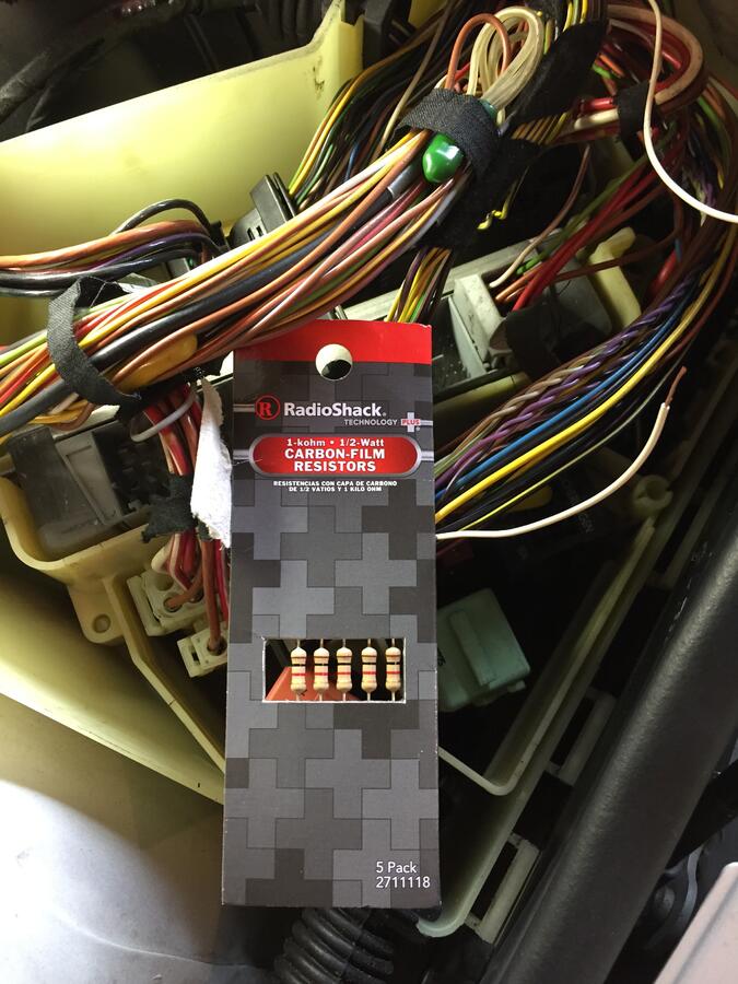

    Hey guys , does anyone know what type of resistor is needed for the SMG resistor mod? I did some research but I’m getting mixed answers.
ID:	32465 It’s been a while but I used this.
    Budget CSL MAP Conversion
      Honestly, I'm not sure if that mod is recommended anymore. The only case in which I think it would help would be if you got a code exclusively because the pump was too hot (not some secondary effect caused by the fluid being less viscous). From what I've seen, I think most people's problems can be resolved by a total pump rebuild or just pump motor replacement. I'm assuming that you're having SMG problems, if so what codes are you getting when the cog light comes on?
        yea, i hear this is not a true fix to the actual problem. relocation (along with the proper pump rebuild) is the better solution.
          Thanks for the info!
            I’ll have to double check the codes again. I figured I would give it a try before manual swapping it.
