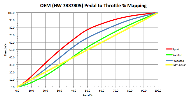

                Good thread on throttle mapping and various things people have tried.
                Our new car came with a tune on it so did our old car. Throttle map seems to be something that each tuner has his/her on preference for. Curious what throttle maps everyone is using for track? Below I am posting two throttle maps, one from our current car and one from our old car. Curious what people's thoughts are.
                Click image for larger version  Name:	image.png Views:	0 Size:	42.7 KB ID:	324997
                If trying to adjust the stock dip in comfort mode:
                https://nam3forum.com/forums/forum/s...1714#post21714
