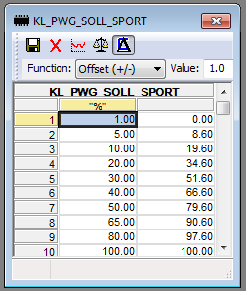

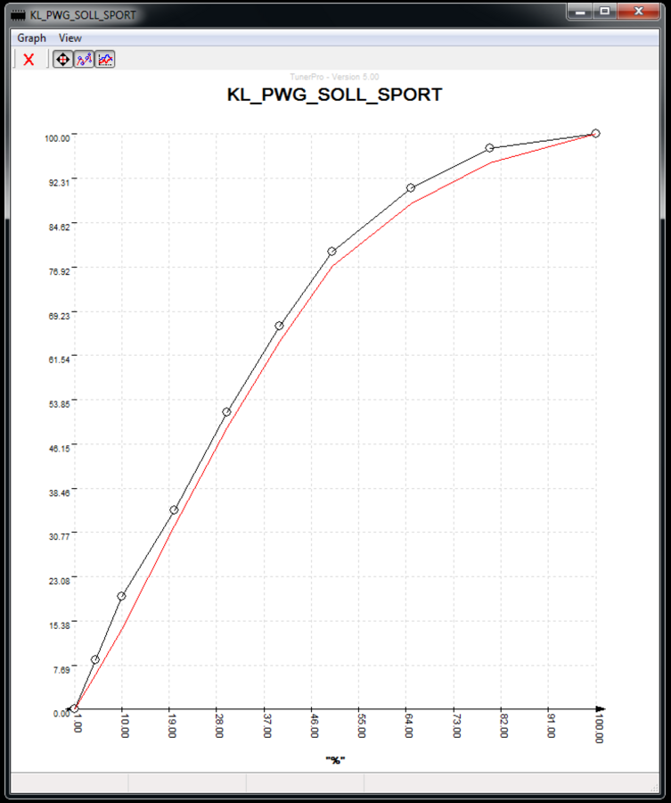

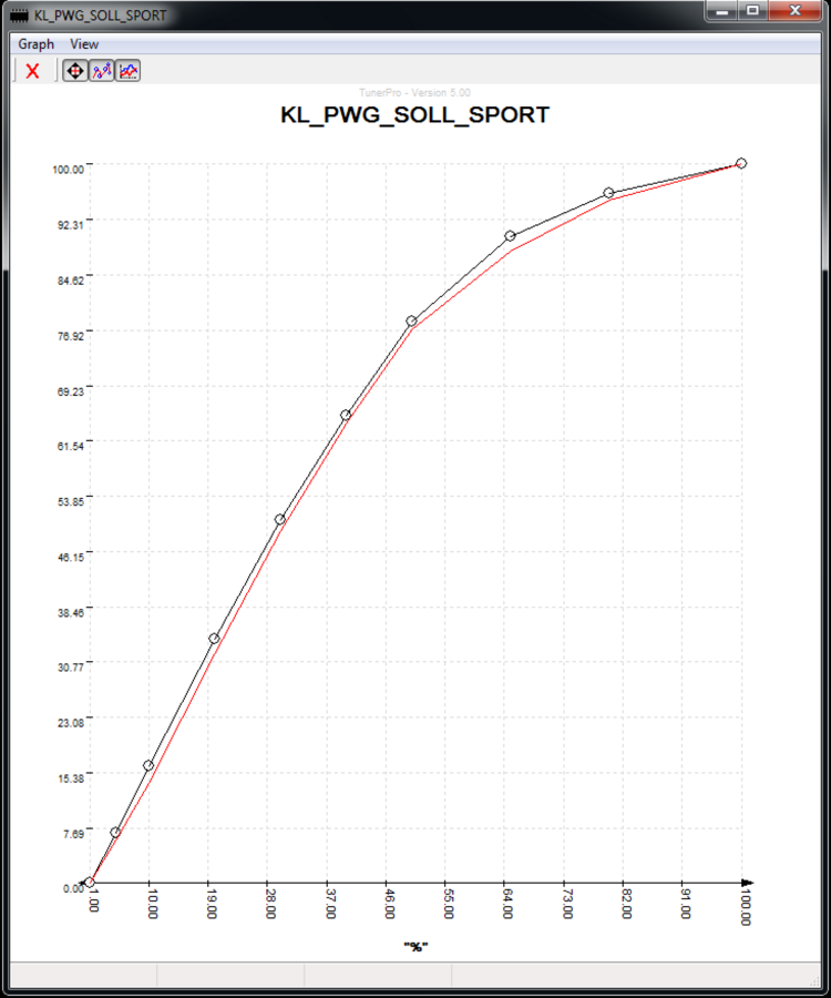

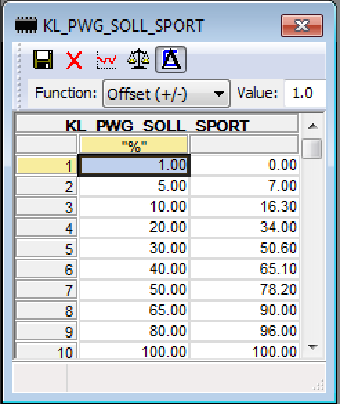

    Our new car came with a tune on it so did our old car. Throttle map seems to be something that each tuner has his/her on preference for. Curious what throttle maps everyone is using for track? Below I am posting two throttle maps, one from our current car and one from our old car. Curious what people's thoughts are.
    This was taken from Polar on M3F and I added in the yellow linear. My Normal is yellow, my sport mode is Polar's 'proposed'.

      Nice! Seems like the tuners like to add more percentage to this map to make users feel that they are getting alot more power after the tune. Polar's proposed seems more reasonable.
      Any chance you have the raw table values or a bin with those values in them?
        This?
        I just used Martyn's tools to input the % I wanted.

          I also use a linear throttle response for both comfort and sport modes. I figure that the brain can better adapt to and understand a line than an arbitrary curve. For comfort mode I had to set 1% pedal to 0% throttle because I discovered that the system gets stuck in sport mode (SMG won't automatically down shift from 2>1) when you set both modes to the exact same values.
