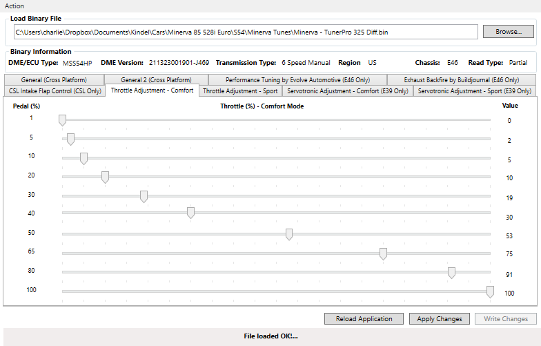

                I've got a Steve Dinan built S54B33 with is tune in my E28. I wired up the cruise control stalk push (which normally toggles between OBC modes) to toggle sport mode.
                I've had to dial the comfort mode WAY back to make the car drivable as a daily. I figured I'd share here, just because I find it humorous.
                Comfort:

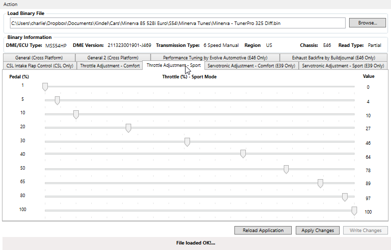

                Sport is still stock, but I will bring the low end down some there too because the car just lurches off the line with the slightest of throttle touches.
