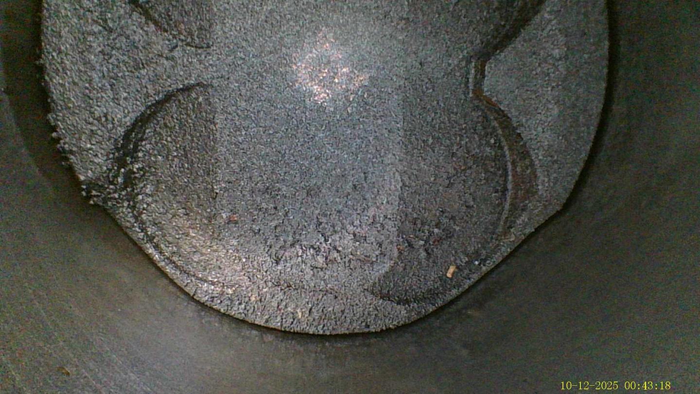

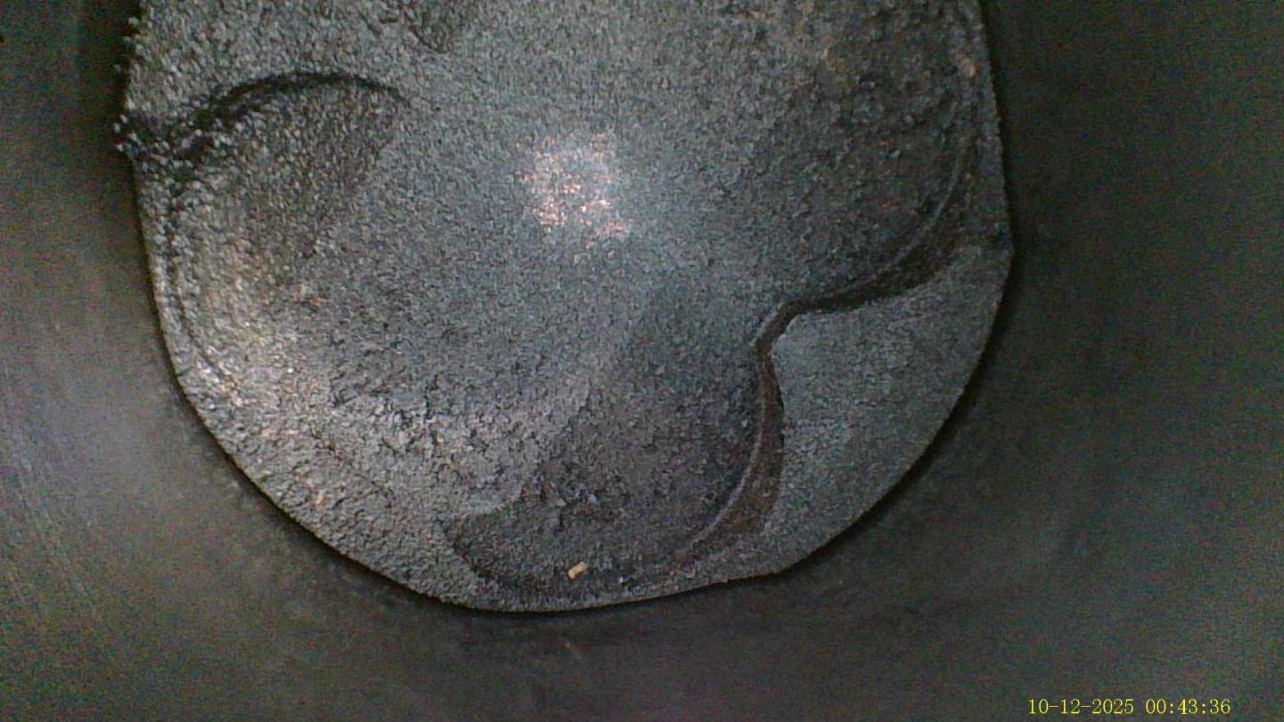

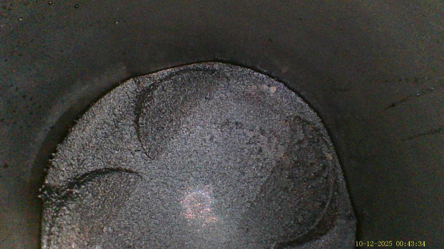

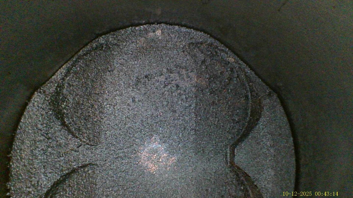

    Edit: Cylinder 6 Endoscope photos added.
    Click image for larger version  Name:	IMG_0010.jpg Views:	83 Size:	185.4 KB ID:	325937Click image for larger version  Name:	IMG_0011.jpg Views:	65 Size:	187.3 KB ID:	325938
    Click image for larger version  Name:	IMG_0013.jpg Views:	64 Size:	170.7 KB ID:	325939Click image for larger version  Name:	IMG_0014.jpg Views:	65 Size:	168.9 KB ID:	325940

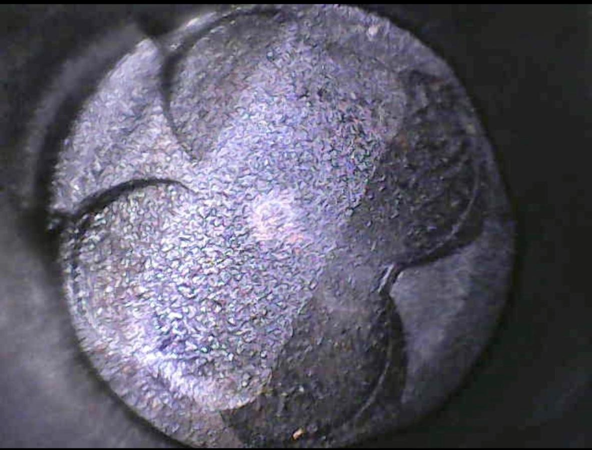

          My endoscope isn't great, but here's what I was able to get:

            I honestly can't tell if those are carbon deposits on the top of the pistons, moisture, or small nicks from pre-ign, det or something bouncing around in there.
            You might need a higher res endoscope to give you an idea of what the cylinder wall looks like. Those cheap WIFI endoscopes can do 1080p.
              I borrowed a better scope and added some pics to the main post, ignore the image dates. There might be some remaining moisture from when I tried using a solvent to loosen up the carbon.
                I edited the original post with an update. I'm back to thinking there is just a valve issue. Currently considering pulling the head and sending it out for a rebuild. Then replace the head gasket and maybe clean the carbon buildup off the pistons.
