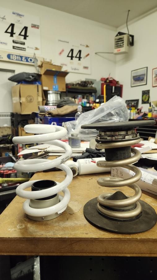

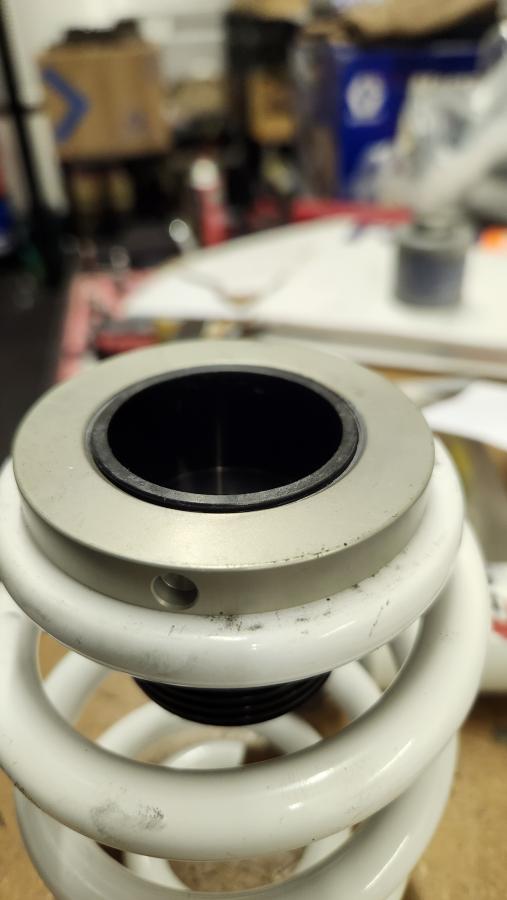

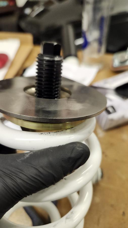

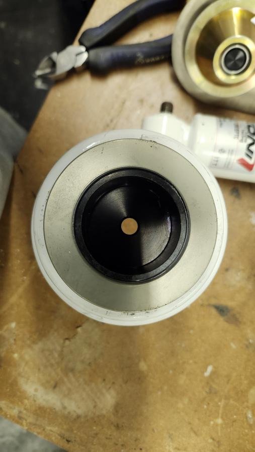

                I am in the process of installing TCK SA's and must say I am slightly disappointed, the height adjusters for the rear springs cover maybe 50% of the spring's surfaces area.
                Why didn't they make the adjuster "body" the same diameter of the spring? It can flop around, and if not perfectly centered the contact area of the spring>adjuster is quite minimal.
                I have set of Rouge articulating perches and they also fit poorly in this regard.
                I know the quality of the BC's I removed is junk however there is no such issues with those, the height adjusters are on top and easily accessible as compared to TCK's adjuster on the bottom.
                Also the BC'S allow you to adjust height independently from the spring plus can utilize the OEM upper and lower spring pads.

                  I ended up switching to 60mm linear springs instead of the TCK bee hive style spring.

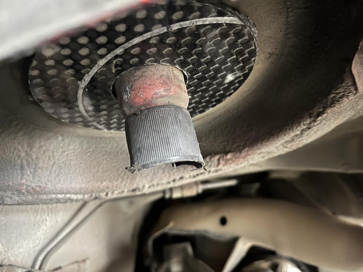

                        If you look at the RACP there the springs sits, there is a nipple with a hole. Take a small aerosol can cap - something like WD40 or brake cleaner - drill a hole in it and run an M8 bolt through it. This will retain the spring when you jack up the car. I've had the same bottle caps installed for almost 13 years, never had a rear spring issue.

                          I…I've had the same bottle caps installed for almost 13 years, never had a rear spring issue.
