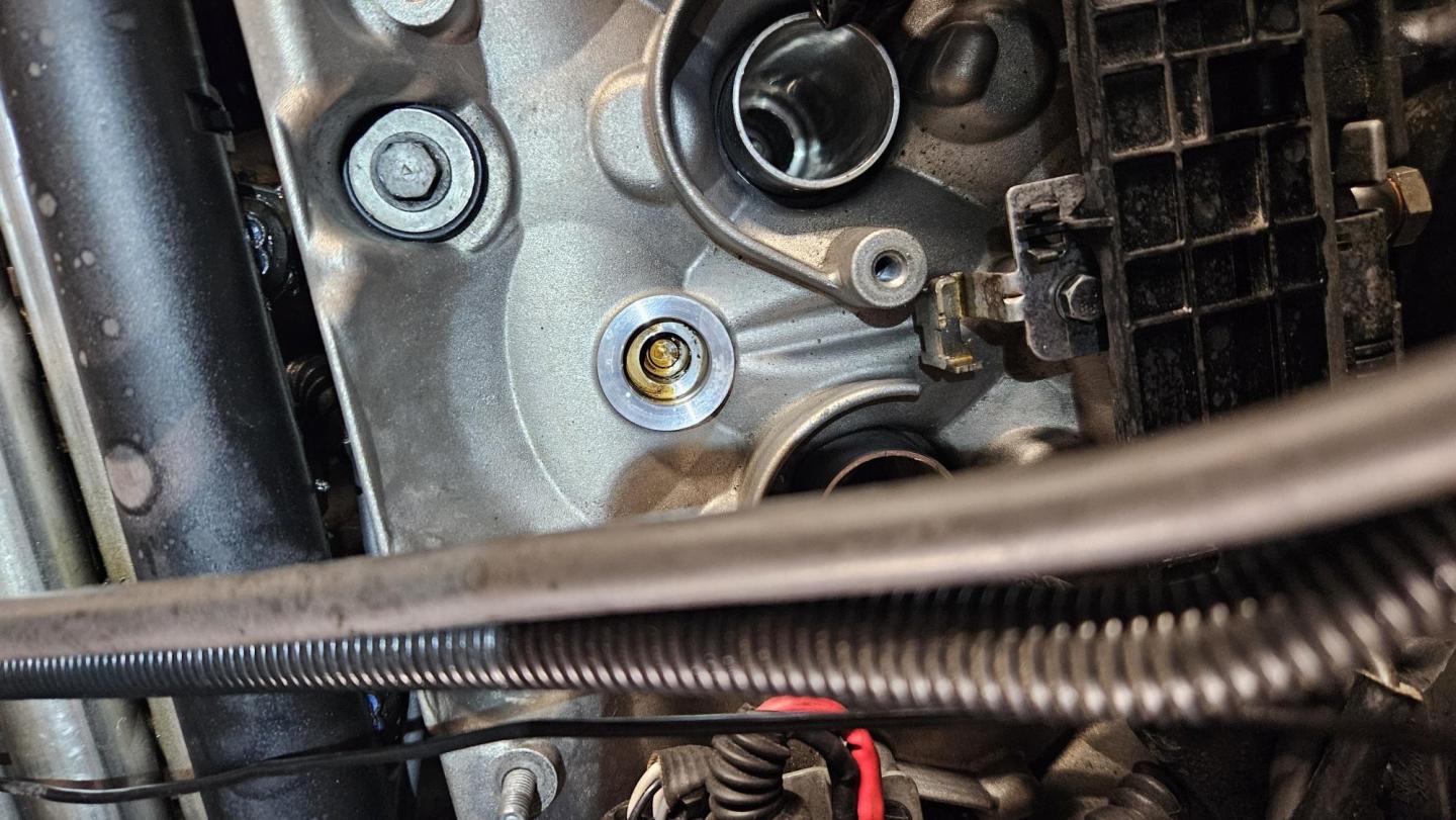

    Click image for larger version  Name:	1000014297.jpg Views:	250 Size:	173.8 KB ID:	327230
    Anyone know what this brass coloured thing is on the valve cover? Connects to the PCV, a one way valve of sorts?

    “Anyone know what this brass coloured thing is on the valve cover? Connects to the PCV, a one way valve of sorts?”
    Not factory setup.
    More details on how the brass tube connected to the CCV (not pvc) and to engine will shed light on the problem
      That is not brass, that is just residual clean oil.
            Not factory setup.
            It's not a tube, it looks like a valve, I tried pushing the center of it but it wouldn't move with medium pressure so I don't think it opens downwards in that case.

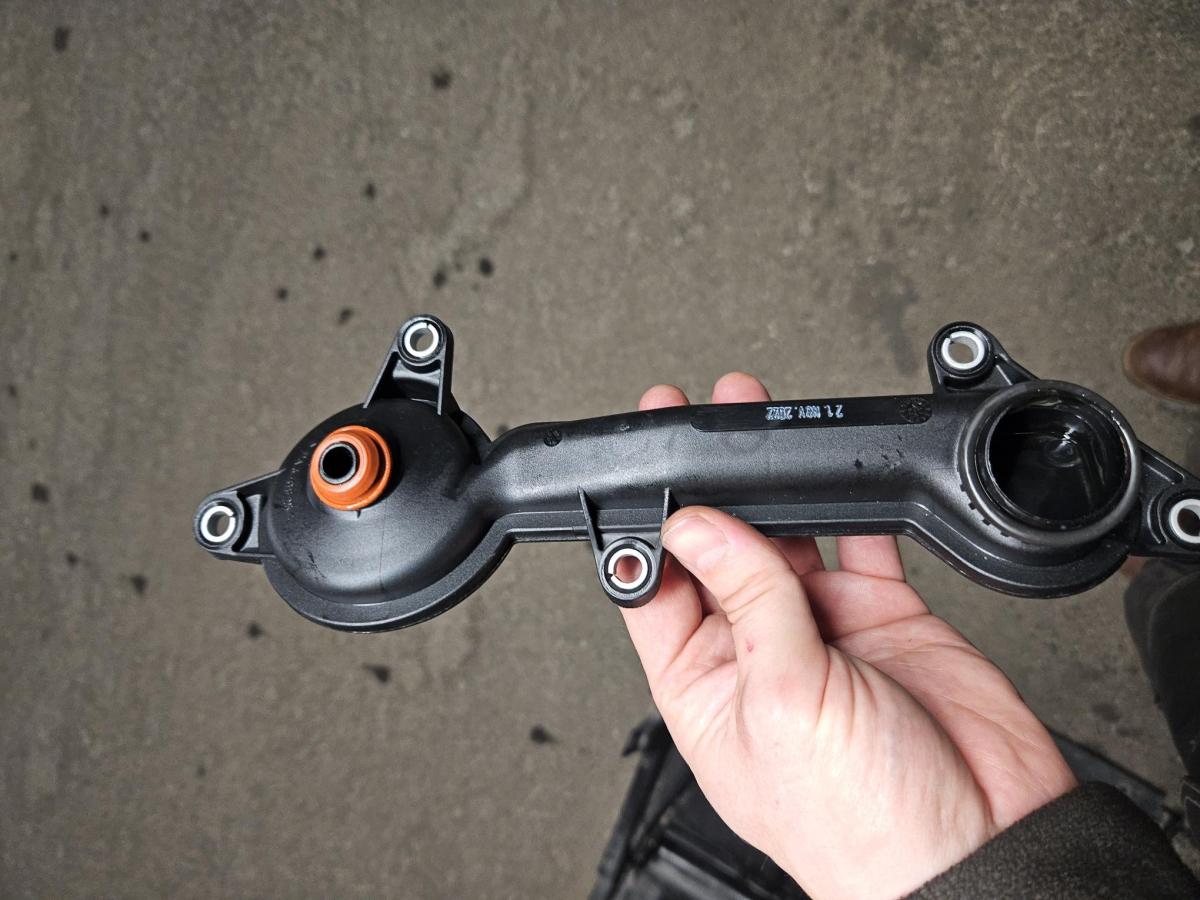

            It connects directly to the CCV/oil separator. The separator has 2 open ends facing the VC and one open end facing up, one channel I guess is the normal open end from inside/below to the valves, here it ventilates and passes through the CCV allowing vapours to condense. The other end faces this brass coloured "valve" and is open straight though to the top opening of the CCV (if all that makes sense).
            On the photo below, these 2 openings face down on the valve cover, the one on the right is the "open" end with a channel through to the left and up to the hose connected to the intake. The left opening on the photo connects to the "brass valve" and on this CCV at least it is completely open straight through to the intake tube.

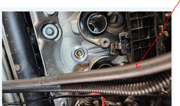

                My bad. I thought the thing pointing by the red arrow is the brass tube, haha. It's the fat 12v cable to the jumper post.
                The good or bad CCV thing cannot cause the oil to pouring out from the fiLLer cap.
                How do you know that oil was coming out from the fiLLer cap?

                  Ah I see, no I'm referring to the brass coloured circle/hole between the spark plug holes
