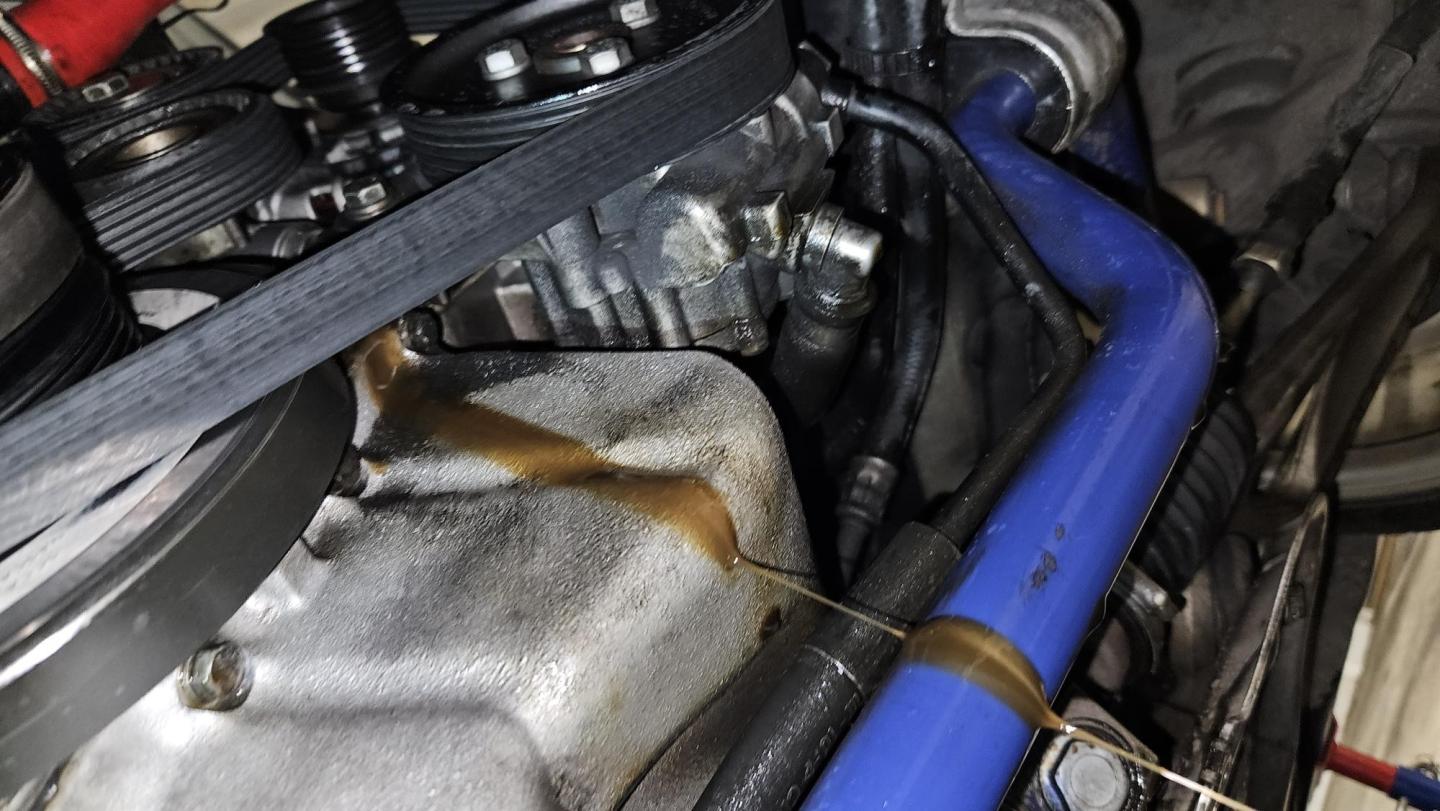

      I think I'll remove some pulleys and possibly the vibration dampener. It only leaks/pours when the engine is running. I wonder if this is a secondary fault after the blowout.. Overpressure maybe blew the sump gasket.. I'm not sure whether I hope it's the sump gasket or the oil filter housing gasket as both require a fair bit of disassembly. But perhaps the filter housing is slightly less messy..

        1. With the engine tilted to the right, the oil leaking doesn't seem to leak from the crank front seal so don't waste time touching the crank pulley.
        2. Not the sum gasket as the leak is at the highest location of the gasket above the oil level.
        3. maybe the oil filter can cover is loose. Bad oil filter housing gasket cannot leak as bad as this.
          I agree, but I find it so hard to see so I'd really like to get the belts off and move the various pumps/pulleys and perhaps alternator out of the way to see better. But I'll definitely take it step by step.
          Regards
            Yes, remove the fan, belt and tensioner/pulleys, and alternator if needed (search for pulling the slide-nut backward 1mm for ease removing), but don't touch crank pulley.

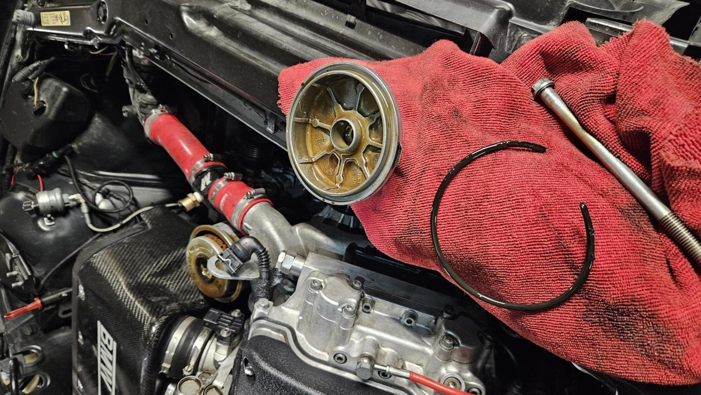

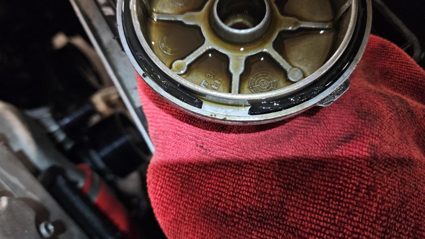

              I removed the belts, the idler pulley and the tensioner, a bit of clean up and started the engine. I didn't think much of the oil filter housing cap, but it didn't take long for it to seep oil.
ID:	328494 Apparently not uncommon for the o-ring to shrink a bit, but you can also see there is damage along the o-ring on each side of the missing bit.. The breach was pointed towards the TPS, so I wonder if the engine spewed oil from this gap, and for my lack of better wisdom, thought it was coming out the oil refill cap, but it probably just pooled in the recess there instead.

                I can't imagine that o-ring in good condition would fail at a pressure the oil pump is able to generate. I don't know the full oil flow path, but unfiltered oil does pass through from the outside to the center.
                Was the o-ring replaced at the last oil change? Mine has always looked fine, but the filters come with a new one so I always swap it out. I think you either had an old, deteriorated o-ring, or perhaps it got pinched and damaged during the last oil change. I'd consider this great news since it's so easy to take care of, put a new one on there and see what happens.
                  I assumed you would have checked the filter can body for oil wetness before doing anything.
                  Re to the broken cap Oring: it was in the groove so the high pressure can’t damage it. Just old or bad oring.
                    There was oil everywhere so a bit difficult to pinpoint the source to the bad gasket at the filter cap. I think also my initial assumption of the oil filler cap led me a bit astray too. I always change these o-rings since they come with the filter kit, but I guess it was either a damaged one or it got pinched somehow.. Will swap for a new one and see what happens next, but I'm fairly confident this was the source of the leak for sure.
                    Regards
