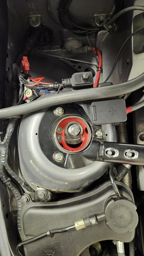

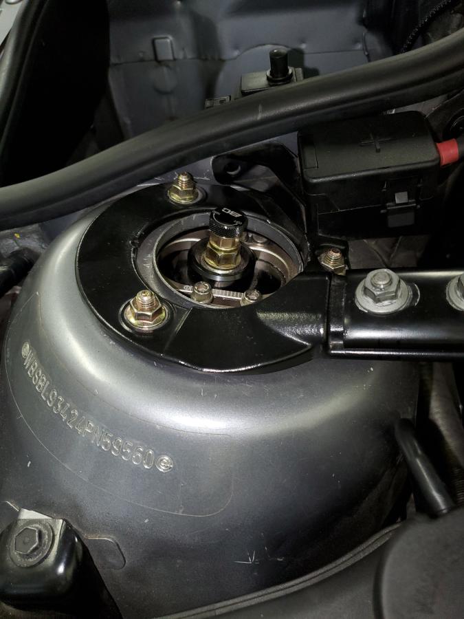

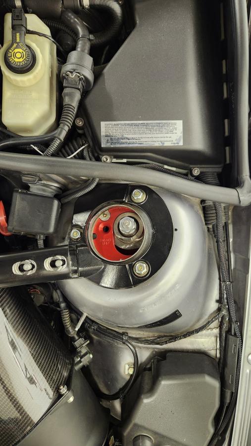

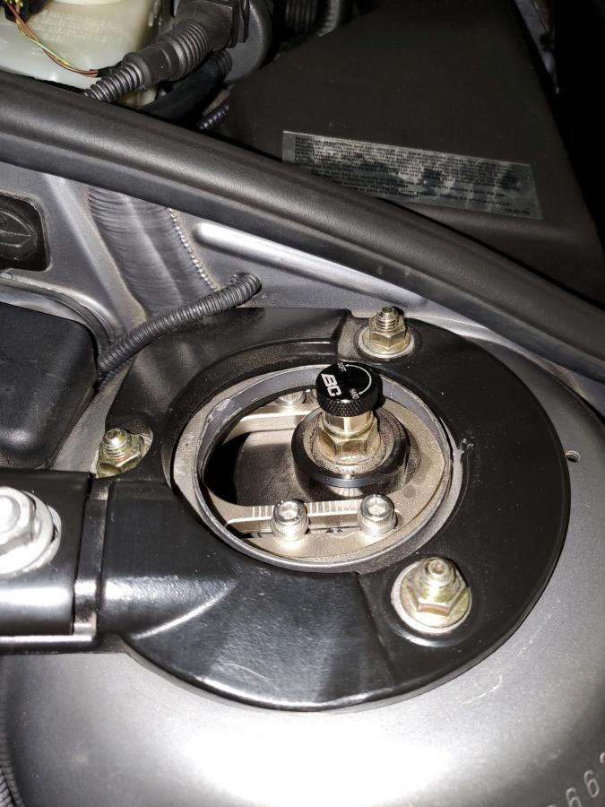

    Well, another fun, and somewhat alarming issue in my saga of new coilovers.
    I have an issue that the camber plate location on each side of the vehicle is drastically different to achieve more or less 1.5° of neg camber.
    FWIW I am using some phone app to get these readings.
    In fact on the driver's side the 88.5 degrees (or ~1.5) is all I can get out of the plate while on the passenger side can be made to get more than 90°.
    I managed to find some photos of my old BC coilovers and their position was similar as well.
    I see no signs of damage in the strut towers/surrounding area, so yeah, really unfortunate.
    At this point I can't help but think best case scenario is a spindle and/or control arm is out of whack or the vehicle is just twisted which is hard to believe.
    Current setup followed by old setup.
    Click image for larger version  Name:	20251122_231316.jpg Views:	0 Size:	74.0 KB ID:	327938 Click image for larger version  Name:	20251122_231359.jpg Views:	0 Size:	76.5 KB ID:	327939 Click image for larger version  Name:	20200822_133707.jpg Views:	0 Size:	69.1 KB ID:	327940 Click image for larger version  Name:	20200822_133654.jpg Views:	0 Size:	87.8 KB ID:	327941

    Is the camber plate is oriented correctly? And is the caster position the same on both sides.
      “Current setup followed by old setup.”
      I see the red plates slots oriented for caster while the ss plates slots for camber.
        Yes on both accounts, I will double check though. I have the arrows on the plates pointing forward, I assume that is correct.
        I can't help but think something is bent somewhere as to align the car on the last set of coils they seemed to be in a similar position.

            Also make sure the plates are on the correct side as well. I know for a fact that people have messed that up...lol. Ok, it was me! I would also check to make sure the strut is seated properly in the knuckle.

                        Looks like you have two different plates.
                        The passenger side plate is centered and the driver side plate is all the way at the outside of the bore.
                        Unbolt them and look for part numbers. This happened to me with my ISC coilovers.

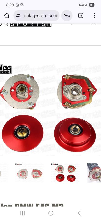

                        Also, if you intend to adjust camber with these, it looks like you need to orient them the other way. Unless these plates are intended to provide a wide range of caster adjustment and a couple of fixed options for camber, it looks like you've got them in the wrong way.
                        If they are in wrong, it might just be the orientation that's wrong on both sides.
                          Now that I look at it closer I think the passenger side plate is facing backwards and has a different caster position.
                            Both camber plates have markings, "RF" and "LF", as well as arrows.
                            I have the arrows facing towards the front of the car and the RF LF markings are on their respective sides. The camber is in the same position, double checked last night. It likely looks odd in the photos as one is adjusted so differently than the other.

                            Here is a photo of the plates so people can see the adjustments.
