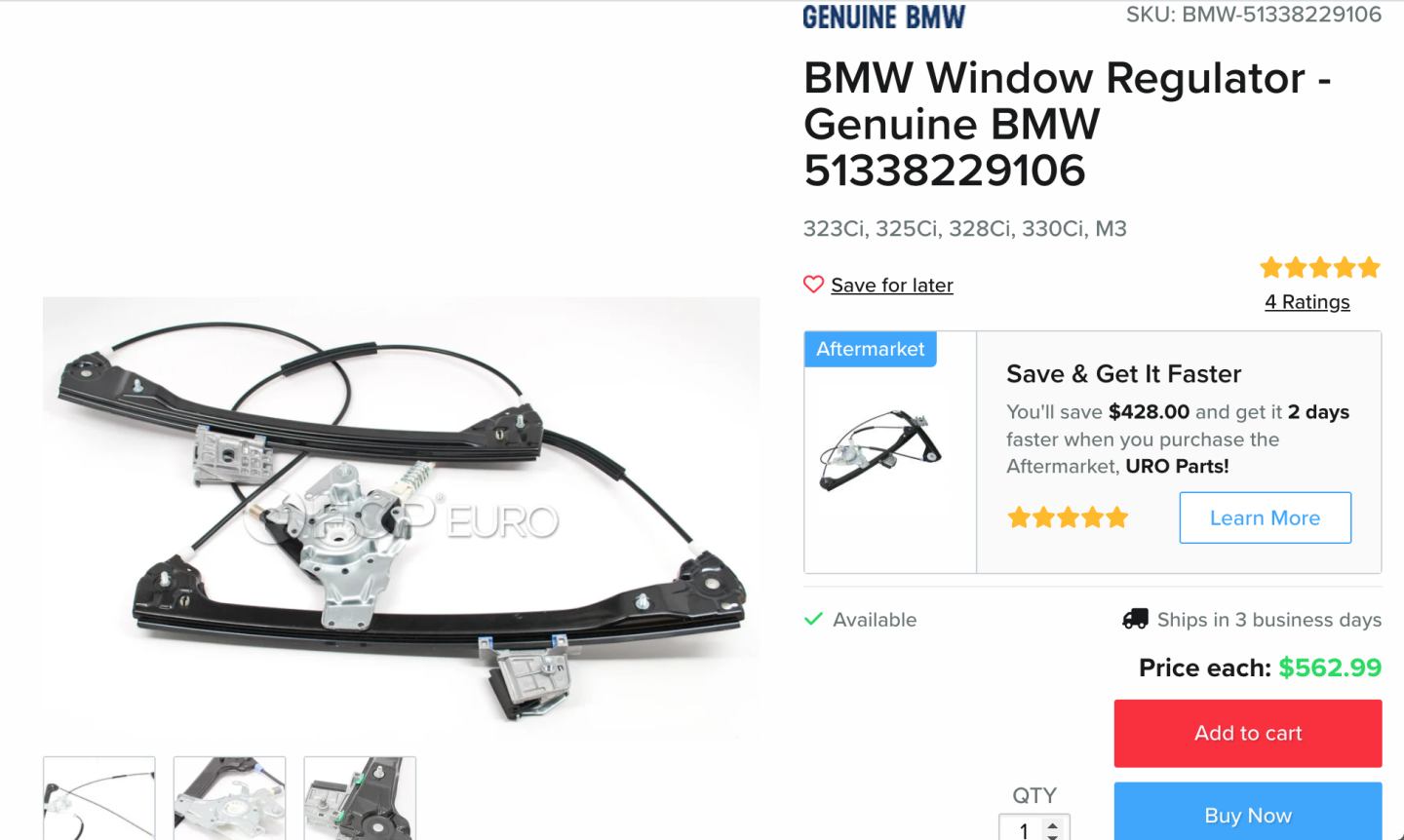

    Hello group — I’m looking at part 51338229106 on FCP Euro and I’m tempted by the ~$430 savings going with the Uro regulator instead of OEM. I only see two reviews on FCP and both are positive, but that’s not much to go on.
    Has anyone here actually run the Uro regulators? Any real-world success (or headaches) to share? I know OEM is usually the safer bet for window regulators, but at a quarter of the price I’m considering giving Uro a shot. Curious what the collective experience is.​

    For any job you do not want to do twice or for a part that is hard to access, stick with the OE BMW or OEM part.

            That's crazy. I just bought an OEM regulator for the e83 and it was $102. This is just price gouging.
            Anyway, I've only had one experience ever with URO and it was complete junk. Stick with OEM.

                  Rockauto has VDO branded regulators for $72. I would gamble on those before anything from Uro-trashgirl.
                  (For all I know they might come from the same factory)

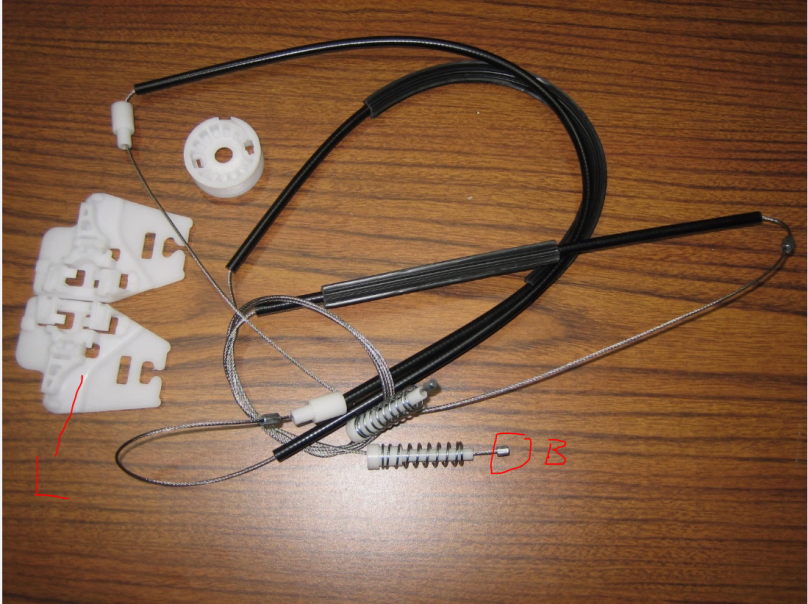

                    The regulator is a simple mechanical part, so I would consider an aftermarket part if it's well made. The weakest link of these parts is the steel bead B cut through the plastic window lifter L in pic below. I improved it by drilling couple small holes on both side of the cable near the bead and will small steel wire to tie the bead down tight to the lifter to avoid the bead cut through. Once it cut through hell broke loose.
                    Good engineering should have made the bead interfaced directly to metal part, not plastic, and have the plastic inserts to ride on the regulator vertical metal rail for low noise and friction.
                    Pic is from ebay seller for the repair kit $9. I would buy the kid to repair the broken stock regulator.

                      As someone that has considered going this route, I appreciate the topic. I would have never learned about Sapote's $9 rebuild option, so great conversation topic. The markup on these wear-and-tear parts is insane, yet OEM seems to be the obvious choice 9 out of 10 times.

                            Neato, about the repair kits. Need to get one, since my car sits outside and that could get me out of a bind. I believe example kit is for a sedan? That is crazy for the price of an OE regulator. Good Lord. It isn't a mission critical part that will leave you stranded, but considering the use it gets (operates every time you open the door) and if you are using the car everyday that would suck with an aftermarket one giving you grief.
