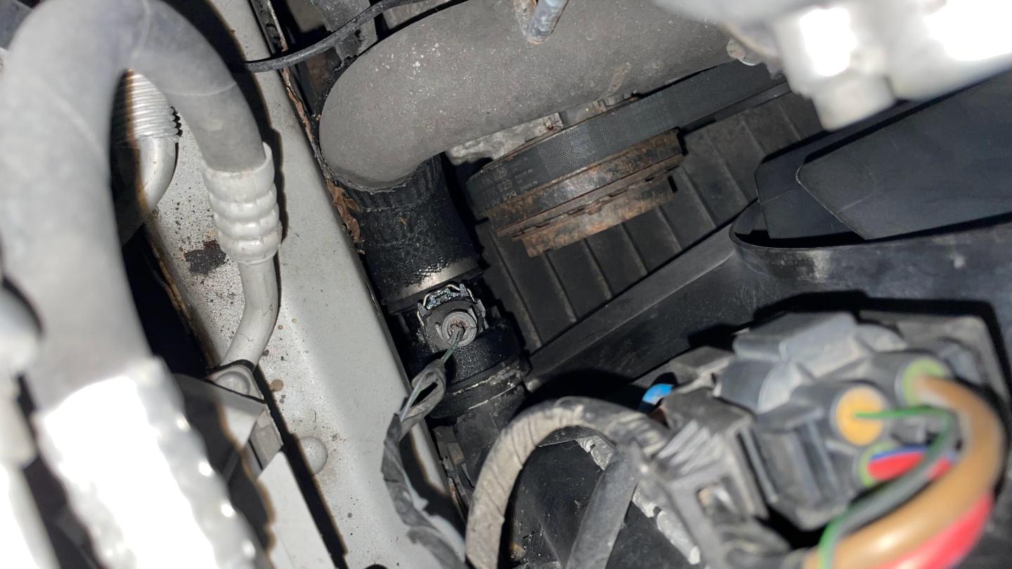

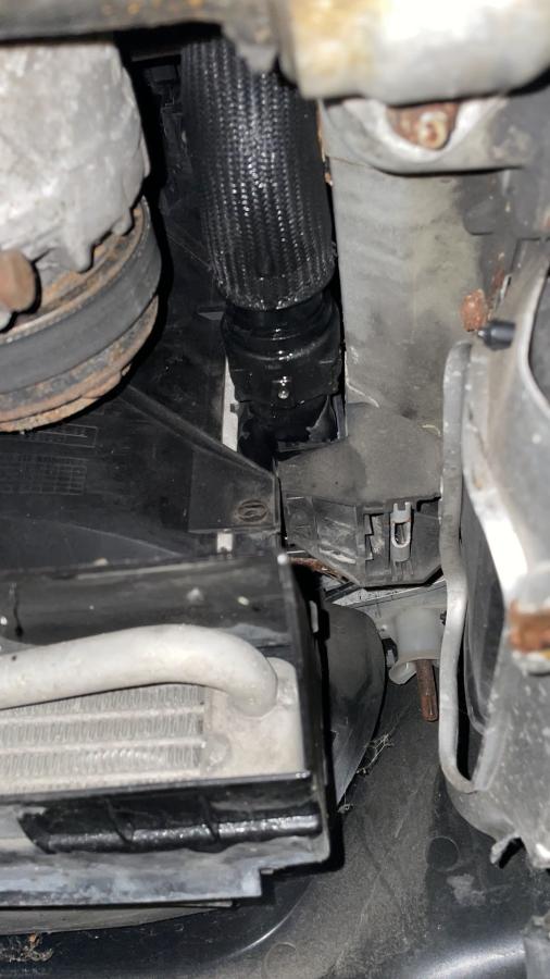

                        The car's been sitting for about a month while I worked on other projects. All of the leaked coolant has pretty much dripped off or dried up, and the only place I can see any moisture now is on the bottom of the lower radiator hose. So I decided to run the engine for a couple minutes to spin the water pump and see exacty where it's coming from. After shutting off the motor, I could see fresh coolant dripping from the bottom of the lower radiator hose. Looking from above, it looks like the plastic piece that connects tot he radiator is wet all around, but not much or any on the actual radiator stub. So I'm thinking best case scenario, it's just the coolant temp sensor o-ring, worst case the hose where the plastic fitting is crimped onto the hose. Anyone know the dsize of hte o-ring and material? RealOEM doesn't show a part number for the o-ring - it's included with the sensor.

                          The o-ring is included in this kit:
                          Complete set of Hi-Temp Silicone and Viton O-rings for the Entire S54 Cooling System. Also comes with the Power Steering, SMG Reservoir and Expansion Tank Cap O-ring's! Replace the factory Buna orings with higher quality Hi-temp Silicone and Viton O-rings. These O-rings have higher temperature rating and more resistant to
                            That o-ring is technically not sold separate from the temp sensor. But it is the same o-ring as the IAT sensor o-ring
                            13621743299
                            Email to [email protected]

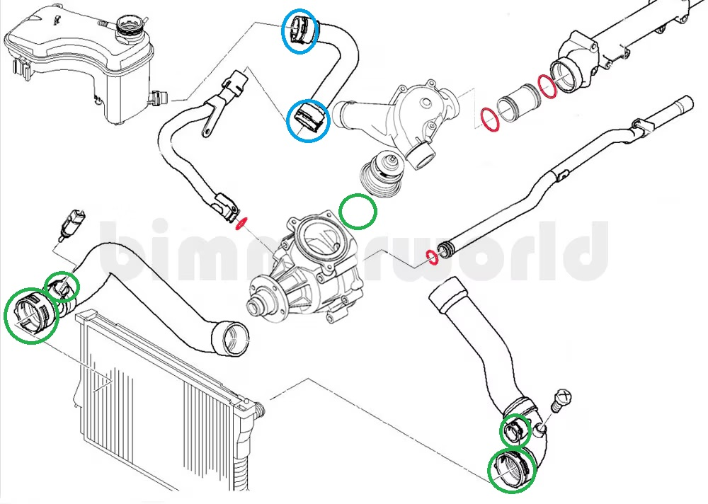

                              Anyone know the sizes of the o-rings circled in blue (at least the one that connects to the reservoir)? They're original, so I'm pretty sure once I disturb them, they'll start to leak. I know someone sells a comprehensive set, but I've already changed half of them, so buying a whole set doesn't make sense. Also, I can pick one up locally same day vs waiting for shipping and customs clearance (which is pretty bad these days).
