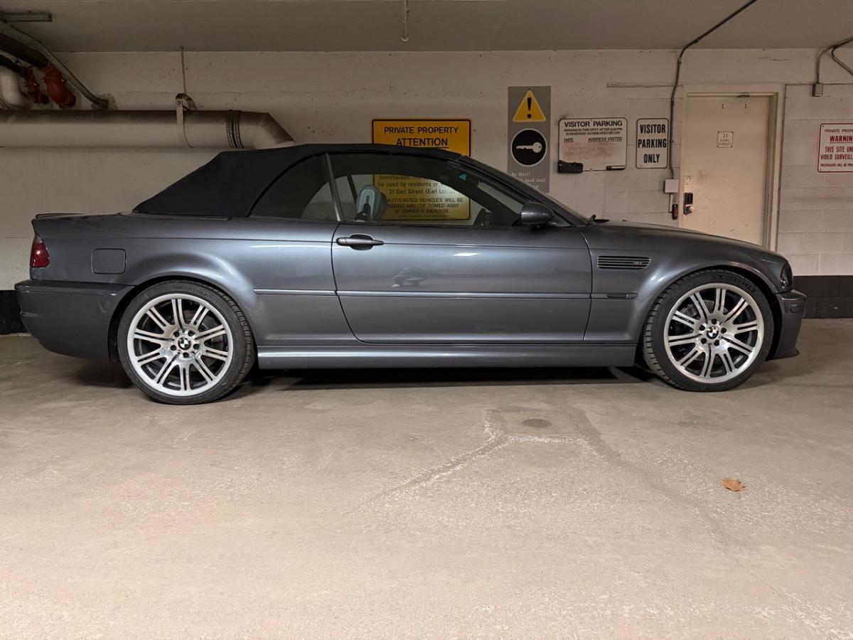

    New to me 2002 M3 cabrio.
    Passenger side rear sits 1" lower than driver's side rear (measured ground to fender). I assume it's a broken spring, but is there anything else I should be looking for?

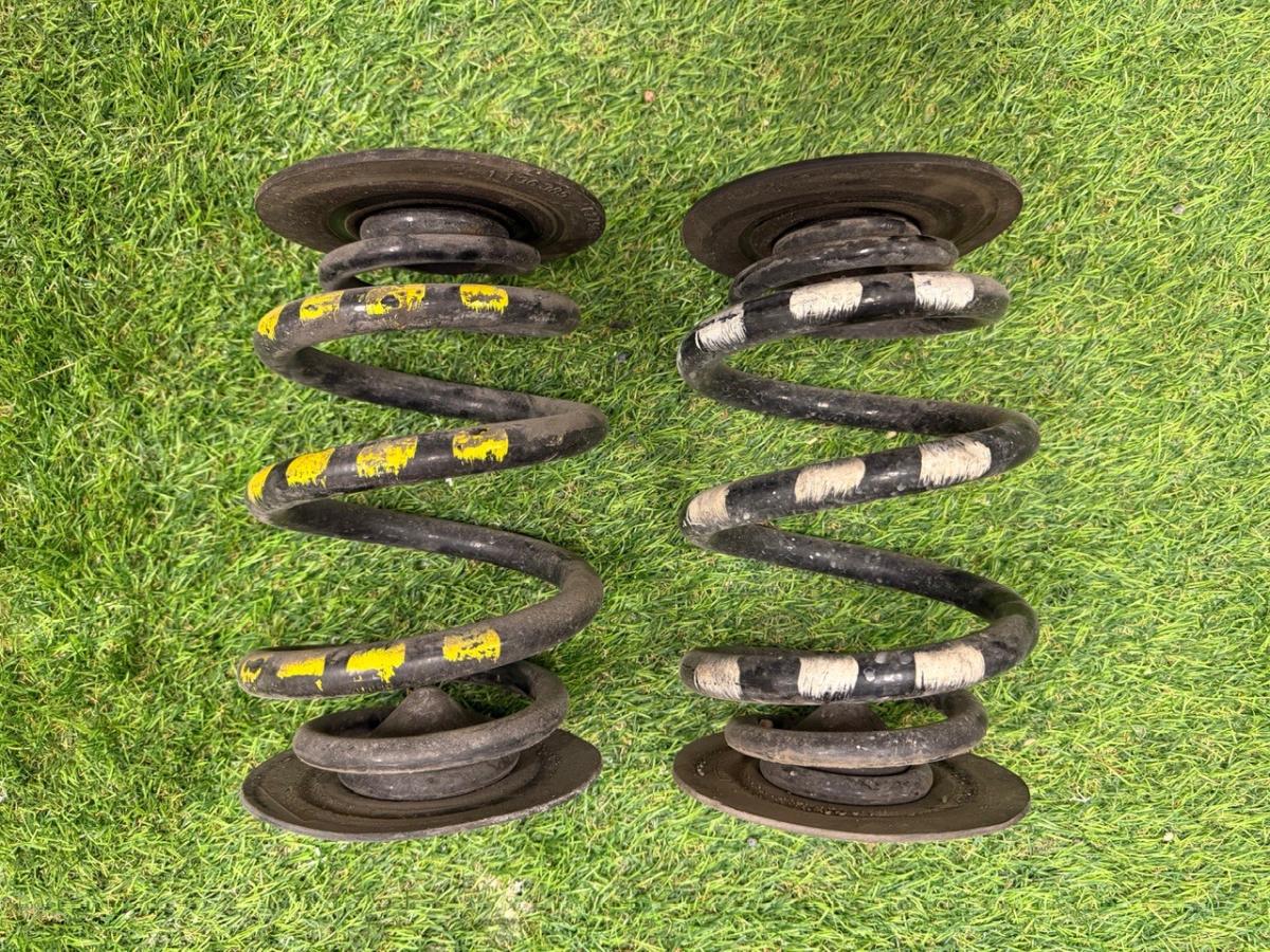

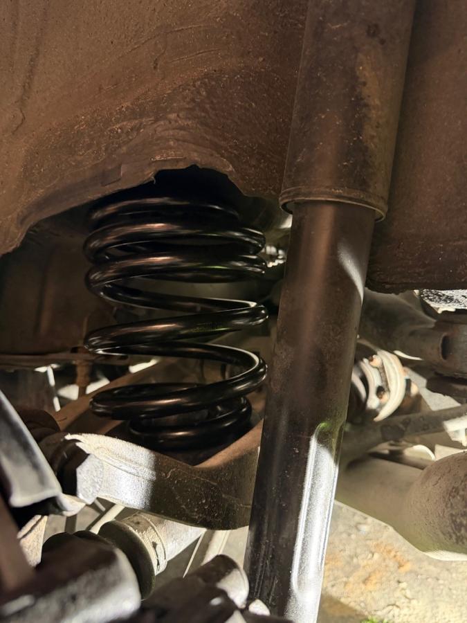

            Replaced the rear springs and swapped the standard 5mm upper pad for a 14mm. Car sits perfectly level now, even fender gap all around. Couldn’t be happier!
              Original springs

                What way did you install the springs? tighter coils on top?
                  Yes I did tighter on top. Couldn’t find a straight answer on what is correct so I went with that.
