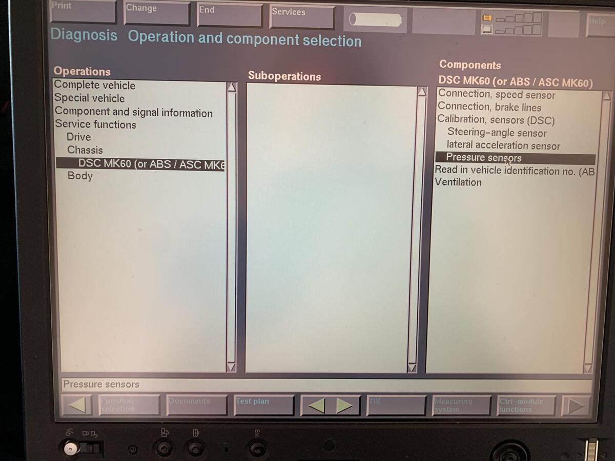

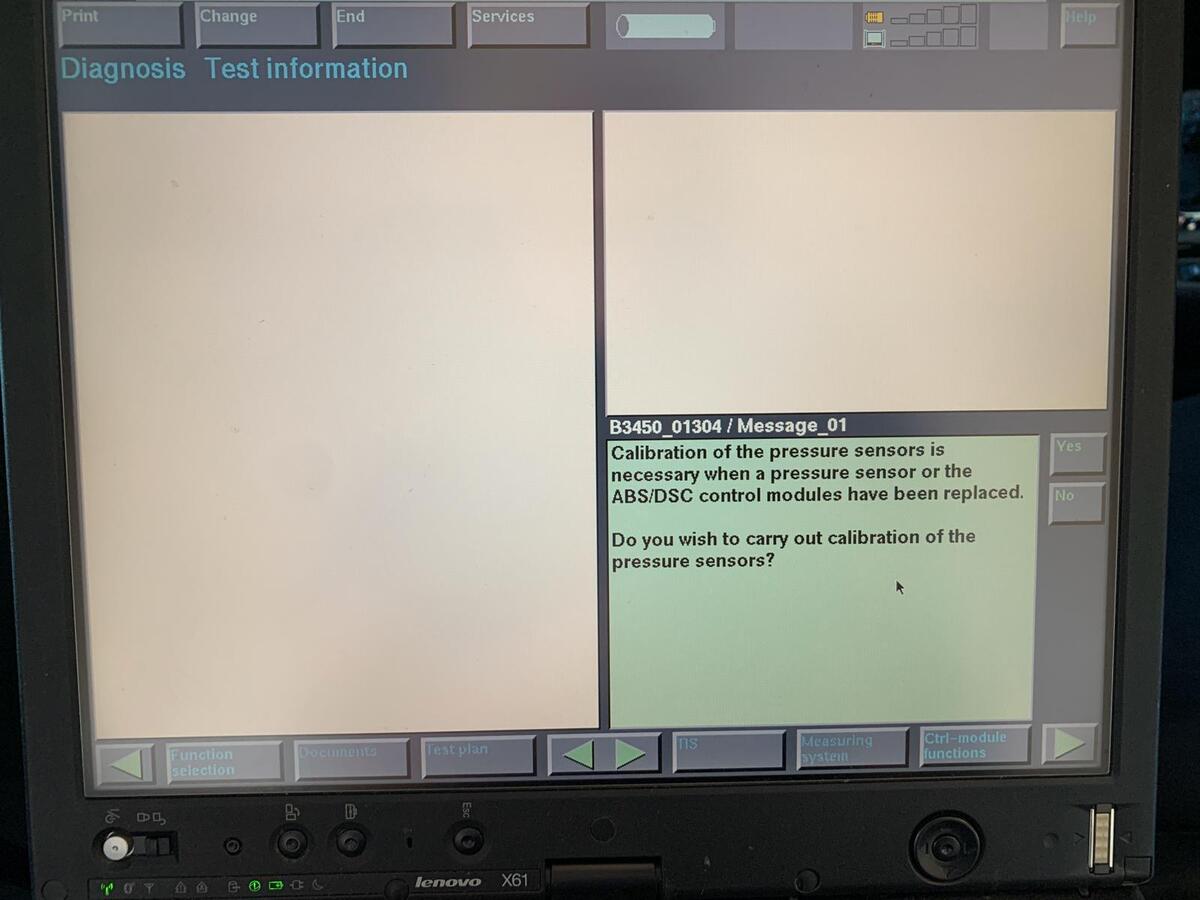

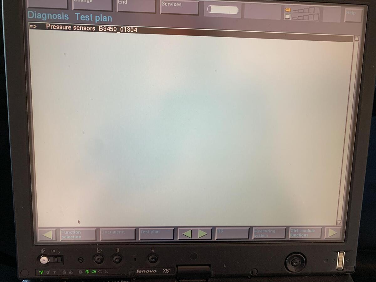

                    you are suppose to realign the sensors once you install them
                    this takes both readings back to zero
