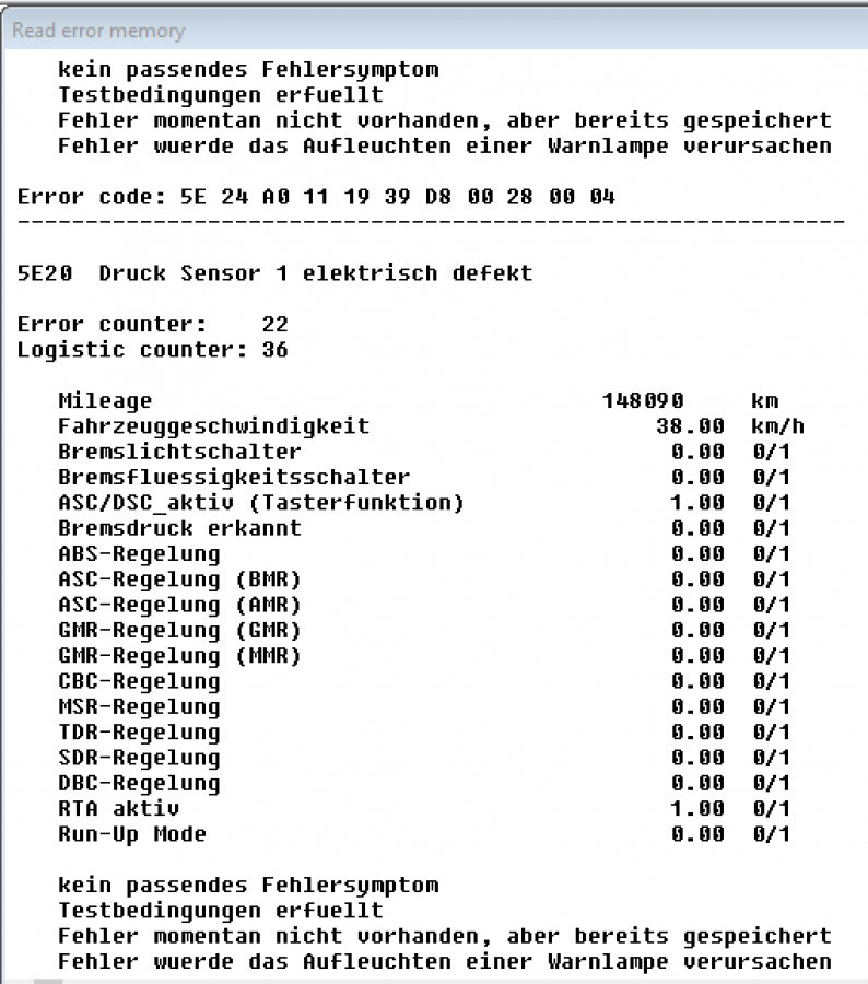

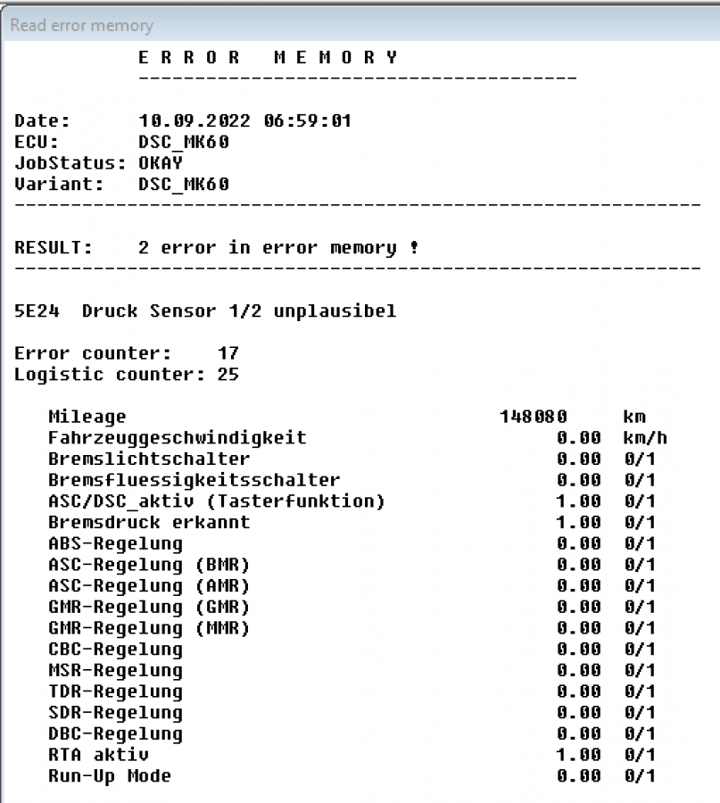

            Did you ever get this resolved? I have intermittent 5E24 with 5E20 on a '05 with 91k miles. I hooked up the car to INPA but did not see any issues on the raw data from the module when the dash lights were off. I am sending the car in to have both sensors replaced this week since the problem looks to be fairly common around 100k miles. Some days it doesnt go away at all, but then is fine for months.
            For those that have a similar problem, with or without the 5E20, my tech suggested that if this sensor replacement doesn't work that it could be an electrical/ connection problem between the DSC module and the sensors. If the problem comes back after replacing the sensors, I would then start looking at the voltages on the wires followed by a module replacement $$. See attached pull from INPA this morning.
