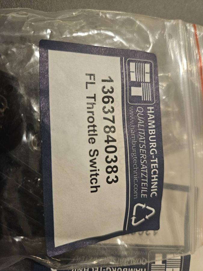

    part # i got is: 13637840383, Hamburg-technic
    what are the chances that both TPS are bad???? strange ..

        but i did my order from realoem part# search, i intend to get TPS for the engine bay ones .. 13637840383 looks correct from the diagram though..
        hope the ones i received were actually for the gas pedal ones..so i don't have to deal with useless parts
