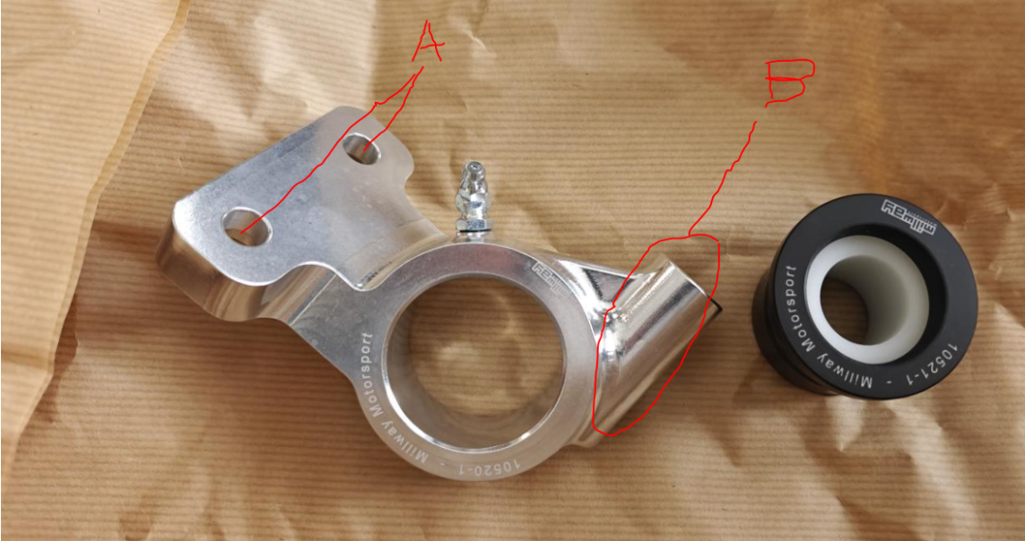

        I'm curious of the function of the bracket B: why do they need it? To serve as a hole and using a metal rod in the hole to level the mounting holes A to the frame holes for mounting the bolts?

          I'm probably telling you something you already know, but the B hole is used to bolt the bracket to the subframe reinforcement plate. I assume it's to tie everything together and stiffen the chassis a bit. I suppose it could be used to help installation, but I didn't have much trouble getting the brackets in place once the bushing was pressed on to the right depth.
