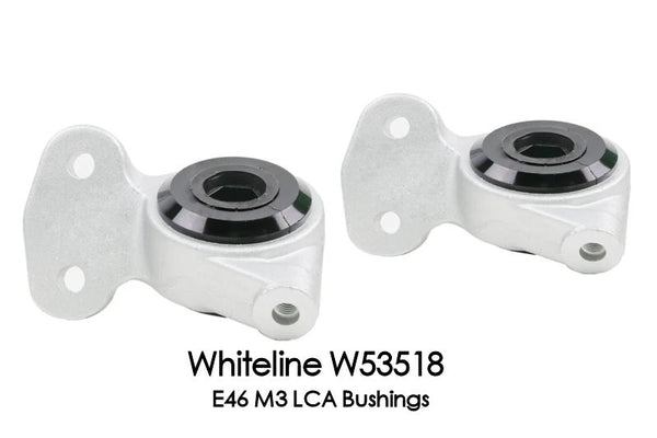

    I bought a set of Whiteline front control arms bushings (W53518) from Turner during the Black Friday sales, and they finally arrived today. Unfortunately, one doesn't seem right to me. On the passenger side unit, the outer bushing is completely loose and will rotate in the bracket with no resistance at all. I'm pretty sure this should be a press fit with no play, but it has probably 10 thousands or more of radial play.
    The drivers side unit seems great, the outer bushing is firmly in the housing with no play. The inner keyed portions on each will rotate smoothly with a fair amount of resistance, as I was expecting.
    This is the first time I've ever messed with a part like this, but this is an issue and shouldn't be installed, correct? My current FCABs seem fine but they're at least 15 years old, so I figured it would be good to replace them. I plan to reach out to Turner or Whiteline one tomorrow and see what they say, I'd like to know if this is normal or not though before I do.

    Why do the inner parts need to be able to rotate? Stock part doesn't have any part/section that can rotate. I would think the whole bushing should not be able to rotate, to achieve a zero plays as its function requires.
        I assume the stock rubber busings have enough deflection where it's not needed, as long as they're clocked properly in the bracket. Many of the aftermarket bushings are a two piece design where the keyed inner portion can rotate freely as needed.

            I talked to Whiteline / Superpro US tech support over the phone. They advised that this is normal, and everything will tighten up and lock into place once the bushing is pressed onto the control arm. I'm skeptical of this answer, if the outer bushing was just slightly loose with very little clearance then I could maybe see it working like that.
              Normal that only one has movement? I'd be asking more questions about that and "tighten up"? I'd be suspect and return them, just run the OE stuff. There is a forum member here ( the_fly )that offers a service to press in new BMW bushings into your lollipops which is very convenient and saves some money. Highly recommended (by me as a customer of his).
              EDIT: Thinking about this, if the bushing is loose in the housing now, with no load--how much does it "tighten" up upon installation such that under load the actual bushing is reacting the loading from the FCA? Yeah, I'd bail on these. I just can't imagine that scenario.
                The keyed inner part: is it a hard plastic Hex shape? Wonder why they needed to make it with hard plastic that requires hex keying instead of having a 1-piece rubber bushing that needs no keying. It broke at the outer join and not the inner part (for stock bushing)
                  I think the design is solid, but one of the new lollipops has a bit too much clearance inside. My understanding is that these are a bit firmer than stock, but less so than most poly options. A lot of the poly bushings now also have a center portion that can rotate like the spherical ones.
                  With this design, the inner portion is tapered to hold it in place. If I push the center outwards so the taper engages more of the outer portion, it does tighten up and lock into place. I think I'll see how it feels once it's on the control arm. If it's still loose and I can manage to press out the outer portion without damaging it, I'm pretty sure I could just take up the slack with some shim stock.

                    If I push the center outwards so the taper engages more of the outer portion, it does tighten up and lock into place..
                    I'm not sure outward is the right word for this; I would think the center piece only can move fore/aft.
                    If it tighten up when you push the center rearward for example, then it also can move forward by itself and cause plays.
                      Yeah that wasn't the best wording. It is actually rearwards in relation to how they're installed on the car. I'm a novice at understanding the suspension design on these car, so I don't know if rearward travel from the control arms is something that occurs, when it occurs, or if some compliance is desirable.

                        I wouldn't use them. The inner bushing should rotate with no radial play. I don't like non-OEM FCAB housings...that might be the issue here. Although I am running the Turner monoball FCABs with an aftermarket housing.

                            I had my sides swapped, it was actually the drivers side unit that was questionable. I got it fitted up today and Whiteline support was indeed correct. Once it was pressed onto the control arm it tightened right up. All the play and movement of the outer bushing to the housing is gone completely. The inner portion still rotates appropriately, firm but able to move as needed.
                            Unfortunately I ran into the same issue as another recent FCAB thread, my threads in one of the mounting holes were completely mangled when I removed the original bolt, which was also damaged. I tried running a tap through it and it seemed like it might work out. I was able to torque a new bolt to 30 ft lbs, but after that it started spinning and I wasn't able to torque it fully. Looks like a helicoil or time-sert is the next step for me.
