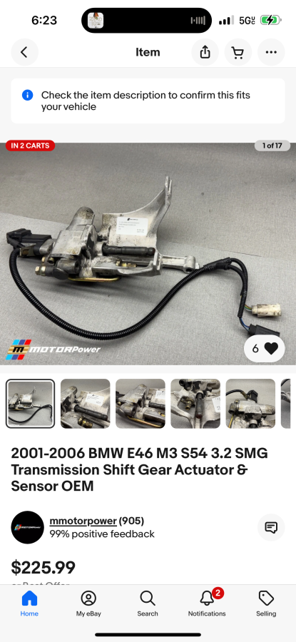

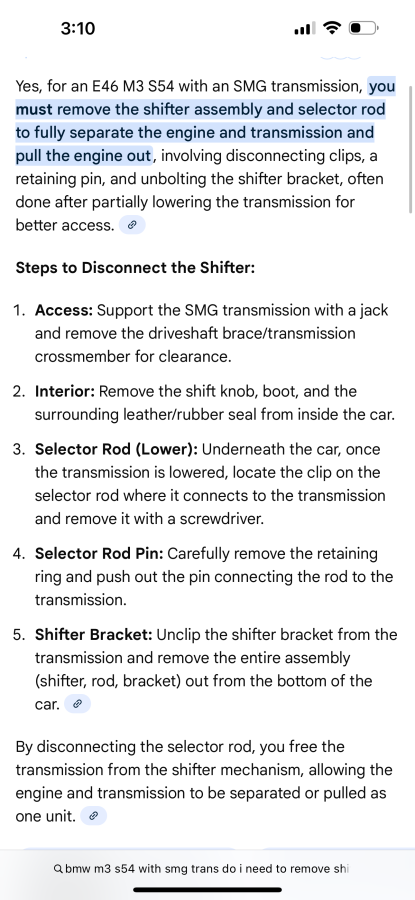

    im wondering if I need to remove the smg steering linkage to remove ONLY engine. I’m leaving the transmission in pulling the engine with a hoist driveshaft and everything is removed. Before I remove bellhousing and motor mount bolts I want to make sure everything is correctly removed let me know thank you!!​

      Thank you for such a quick reply! I’m referring to the smg shifter directly above the driveshaft
        Oh ok. Your original post said 'steering linkage.'
        If you're removing the engine and transmission together as a unit, you should be able to get it out with the actuator still attached. It extends probably 6-8 inches past the end of the transmission but it shouldn't really be in the way if you have plenty of room under the car to tilt everything.
        If you're removing only the engine, you definitely don't need to mess with the shift actuator. Just separate the SMG Pump from the engine and get it out of the way. You should be able to leave the hydraulic lines attached and just strap it up off to the side somewhere.

            I’m leaving transmission in
            Thank you for such fast responses!! In theory I could’ve left the driveshaft in place & pulled the engine out (leaving trans in)?

              Yes. Just pull the engine out.
