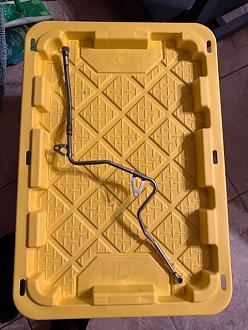

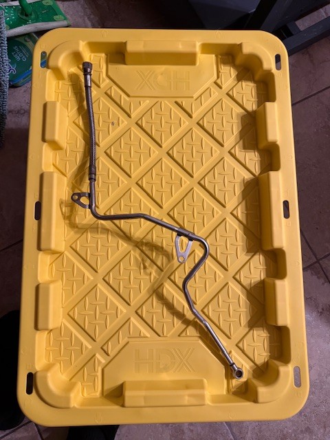

                          Found an updated OEM line in case anyone needs/wants it.
