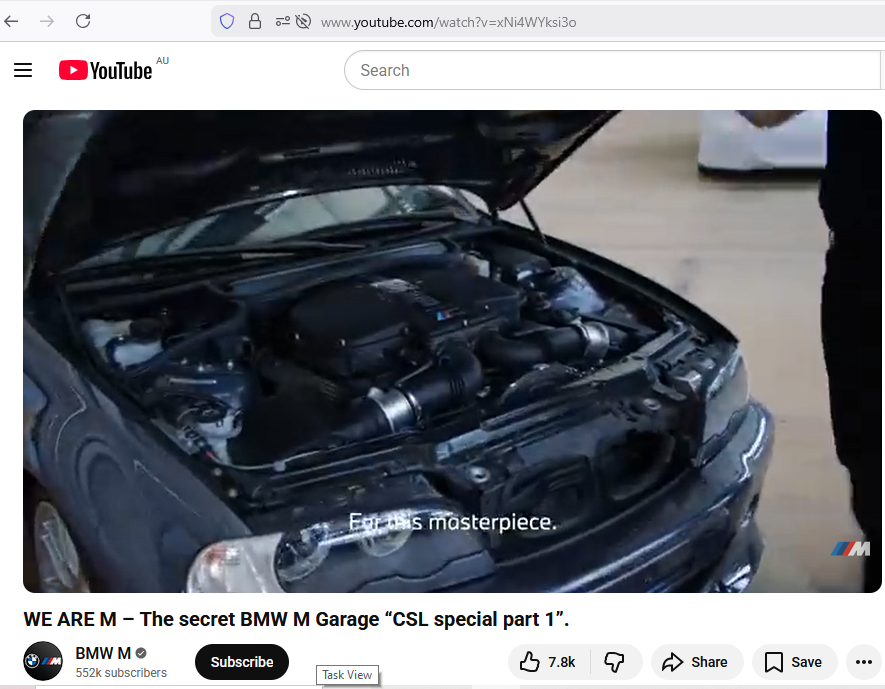

                        BMW-M made the S62 work?

                              Yeah but I'm sure they have a lot better tools, data
                              and info to integrate everything.

                                Yes and with SMG! That would be my dream swap or S65 DCT.
