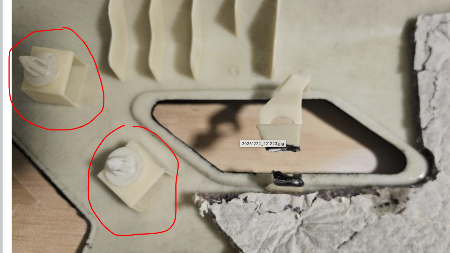

    heinzboehmer just came up with a solution for c-pillar tabs:

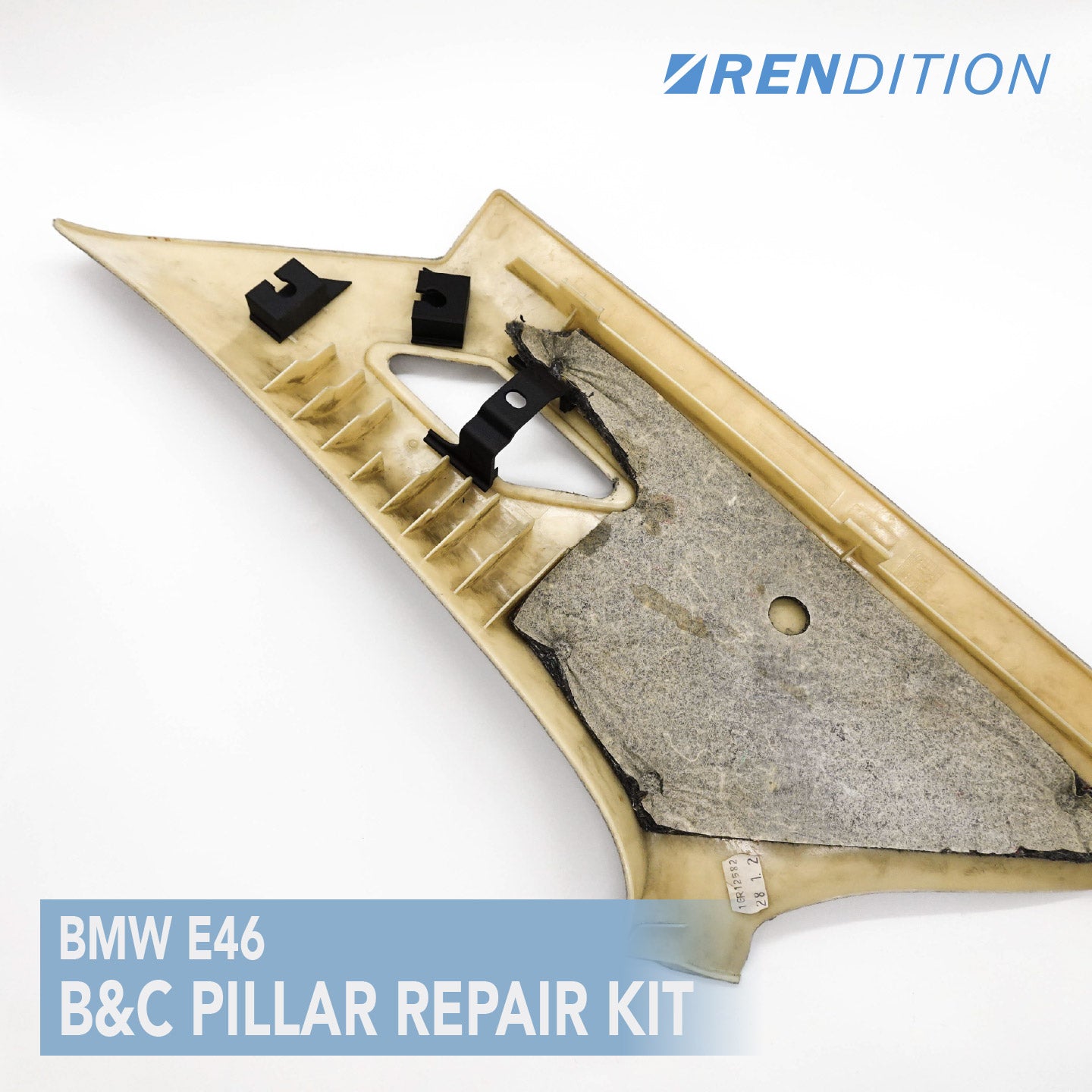

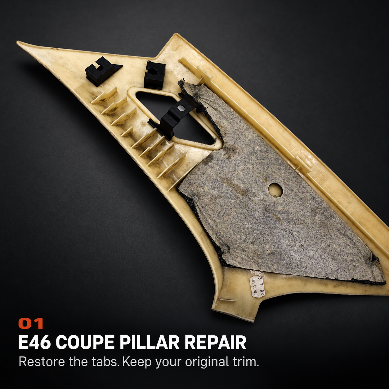

    Otherwise, this is rendition's fix for the c-pillar:
    BMW E46 Coupe C-pillar trim replacement made from carbon fiber-infused composite. Permanent fix for sagging or cracked OEM interior trim.
      https://renditioncustom.com/products...lar-repair-kit
      Yea I saw Heinz's fix, looks great. Mine have those parts broken as well as the square mounting points.
