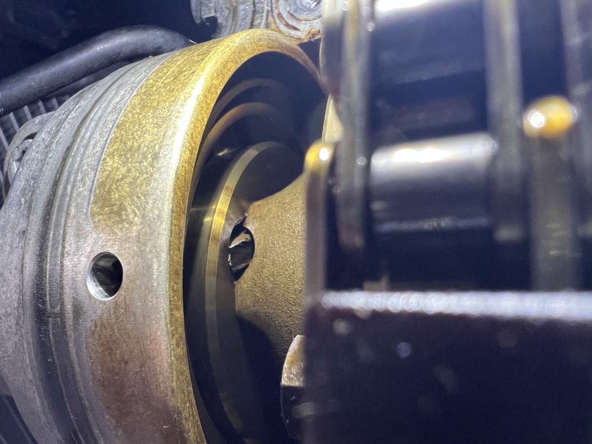

    2) I have no idea if anything has been done to the Vanos. The bolts on it are hex, and I know BMW swapped to torx bolts sometime after 2002. If it had a new vanos I would suspect to see torx bolts. Although, maybe it was internally rebuilt and they kept the old hardware.

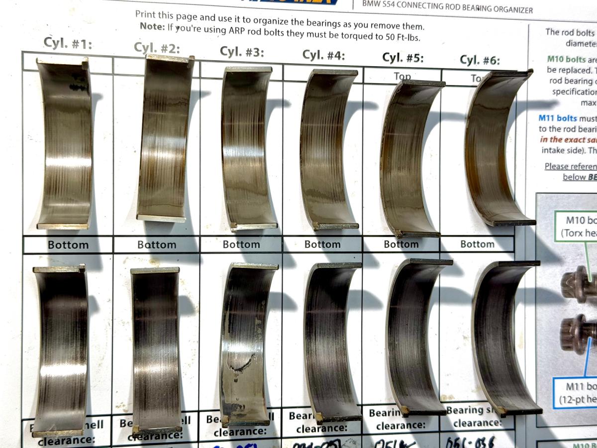

    3) Rod bearings. Oh Lord help me. When I changed the oil, it was like I was panning for gold. There's a lot of copper. I sent a sample to Blackstone though, that way I can see how f***** I am scientifically.
    Any and all advice, suggestions, or reprimands are welcome and encouraged. My plan now is to start calling local shops and getting quotes for the rod bearings. I know I said I wanted to do all work myself but that seems like a big job and I don't trust myself that much for something as important. As far as work I want to do myself, I want to get rid of the lowering springs. I'm currently doing research on what kit to get, but any recommendations would be sick. Again, I want to daily this car. I'm not trying to turn it into a track car (yet). I want something sick af I can daily that's as reliable as it can be.

      2) You’ll want to inspect the VANOS exhaust hub. Make sure both tangs that drive the oil pump disc are still intact. Mine had one that was broken off. The replacement bolts from the kit I installed were torx under the hubs and hex to secure the hubs. Attached pic is how I knew I needed to do some work.
      3) My car had the recall rod bearing replacement. It probably would have been fine for another 20k miles, +/- 20k miles, but they will need to be done even if they were replaced under the recall.
        I'd recommend parking the car until rod bearings have been changed. Towing it is far cheaper then a new S54.

          Thanks for the tips guys! I found the rod bearings DIY guide on reddit, the one with like 300 steps and pictures. Would it be a bad idea to try to do it myself?
            Personally I would do an oil change and run an oil analysis and then another analysis in the next 3-6 months to ensure consistent results before doing rod bearings. At your mileage you are likely due though so couldn't hurt. I have 2004 that I've owned for 10 years and have done an oil analysis every oil change since I've owned the car. Came back with perfect results every time so I've never done rod bearings. Just something to consider
              I gotcha. I'm going to wait until I get the analysis back and see what that says. I'll start studying tutorials and doing research on the DIY, start making a list of what I'll need as far as tools and parts. I might try to do suspension work while I have everything dropped anyways. There are only a couple days a week where I need to drive the car so I will keep drive time down until I get more info.

                              Rod bearings is quite the under taking for a relatively new enthusiast. You will have to purchase a lot of tooling. The glitter in the oil does not give me a good feeling.
